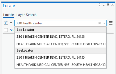

I've had a multirole locator (v2.7) built with point address, street address, poi, and postal locality roles along with alternate name tables. The locator has worked well but lacked the ability to reverse geocode by postal locality:

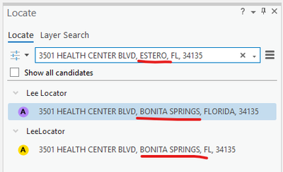

I've been working on reconfiguring it with ZIP and city roles to support reverse geocoding but haven't gotten the configuration just right. The main problem I'm running into is that with "Preferred City Name" set to "Local", it suggests the local city name but returns the postal city name. This behavior is the same both locally and from the geocode service (10.8.1):

FYI, I ended up using a configuration with postal locality and city roles (no ZIP). This suggests and returns the desired city names when searching. It also allows reverse geocodes to return city names when a point or street fail to match.
This is close to the functionality I'm looking for. It would be nice if the postal locality role supported reverse geocoding as well.
