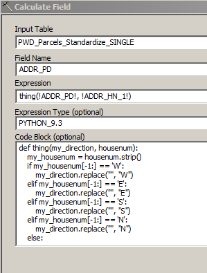

ShannonGrumbly2
Regular Contributor
I thought I was close with this code (ending in "else: return my_direction"):
But it returns <Null> for any row where there is a W, E, S, or N attached to the end of the housenum.
TimWitt2
MVP Alum
Shannon this worked for me:
Pre-Logic Script Code:
def SPLITTING(test, test2):
 if (test2 =='') :
  howmany = test.split(' ',1)
  if (len(howmany) > 1):
   return test.split(' ',1)[1]
  elif (len(howmany) == 1):
   return
 else:
  return test2
PreDir box
 SPLITTING( !HouseNum!, !PreDir! )
ShannonGrumbly2
Regular Contributor
Thanks for your response, Tim. This code does not produce anything for housenum that ends with a W, E, S, or N for me.
This is a direct copy and paste from the table:
449-57 E
I'm not sure if there's a different character or something in that value that's different from what you have.. I get "WARNING 000405: No records within table."

ShannonGrumbly2
Regular Contributor
Whoops! I was working in an older version of that table. It works in this table, though. Thank you!
