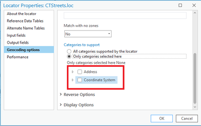

@ShanaBritt, My locators were initially set to 'All categories supported by the locator'. When I clicked 'Only categories selected here', I only see the 'Address' and 'Coordinate System' categories. Where/How can I  find the 'StreeName' category?
JoshKalovGIS
Click on the arrow next to Address. that will open the address related subcategories that you can select/deselect.

Thanks. @JoshKalovGIS. I am testing this now.
FrankMatzen
Thanks Shana. I am using a composite locator. This morning I did more testing, and was able to successfully disable the StreetName category, so addresses won't match to streets without an address range.
