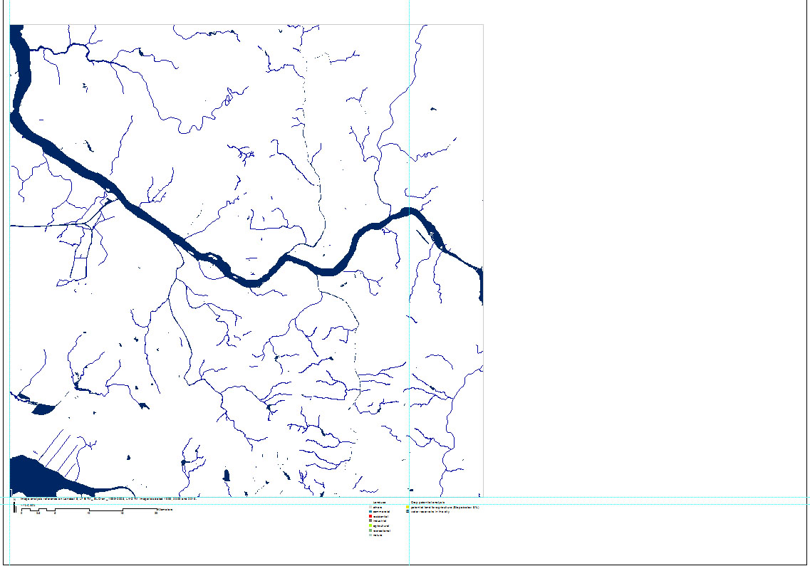

I have exported a jpeg from layout view. It looks completely fine as a shapefile feature class looking like the first image.

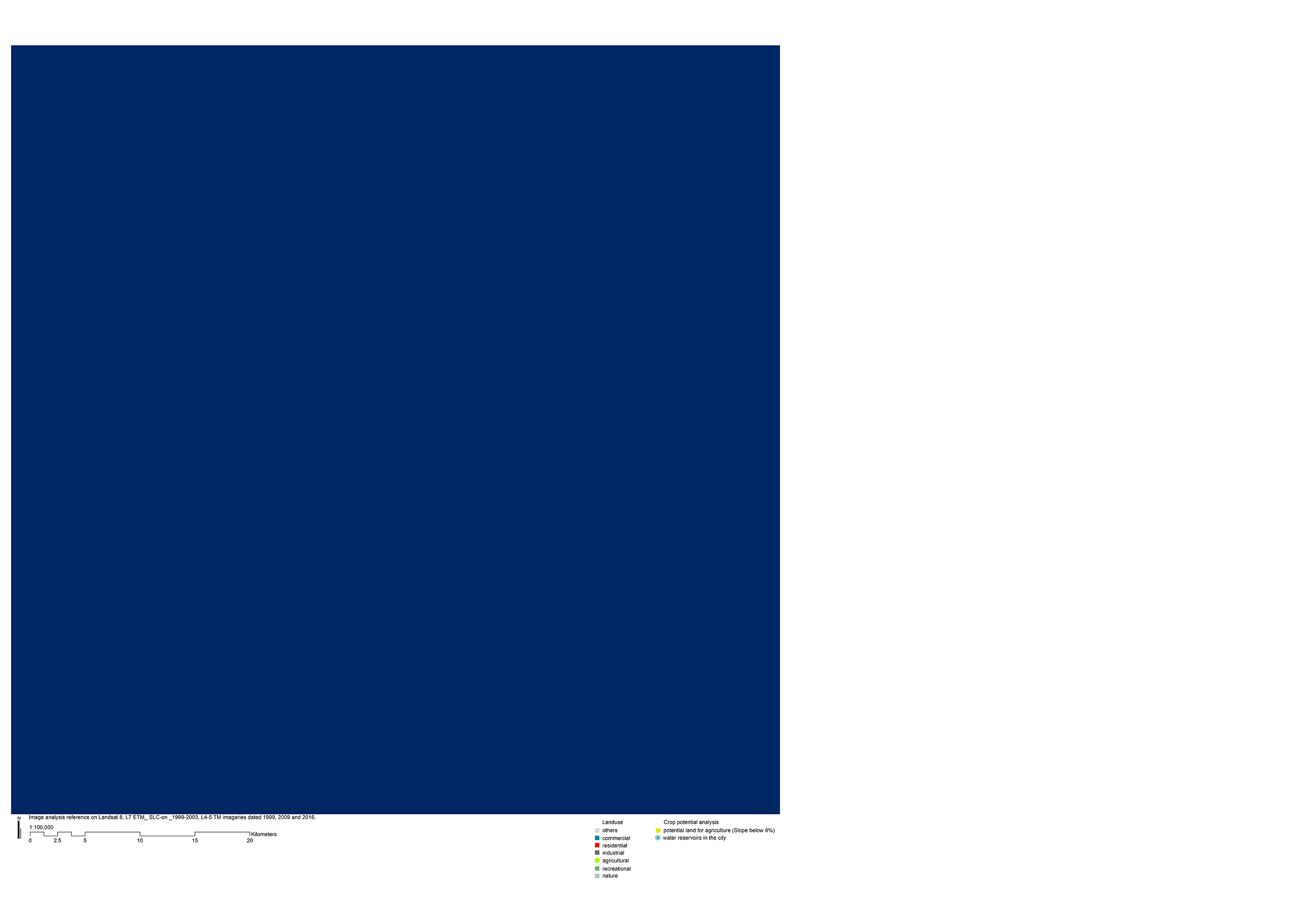

Then when I export it failed and black out like the second image. Can somebody explain why and how am I supposed to solve it?

you said shapefile... if it is a shapefile, then you have a geometry error and you are getting bleed-through... try a Repair Geometry to see if it gets fixed

Is the first image a jpeg or a shapefile?
Is the second image a jpeg or a shapefile?
If the 2nd image is the result of the export of a shapefile... then you have geometry errors
