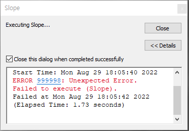

what is the problem of my dem?
729
08-29-2022 02:06 AM
Koofrey

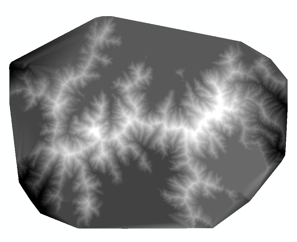

I made dem from 10m-countour(create tin→tin to raster→fill).
I'm trying to calculate slope and aspect with this dem.
But it just gives me an error message 999998.
I read an article that using geoprocessing background can affect on
Is there any problem with my dem?

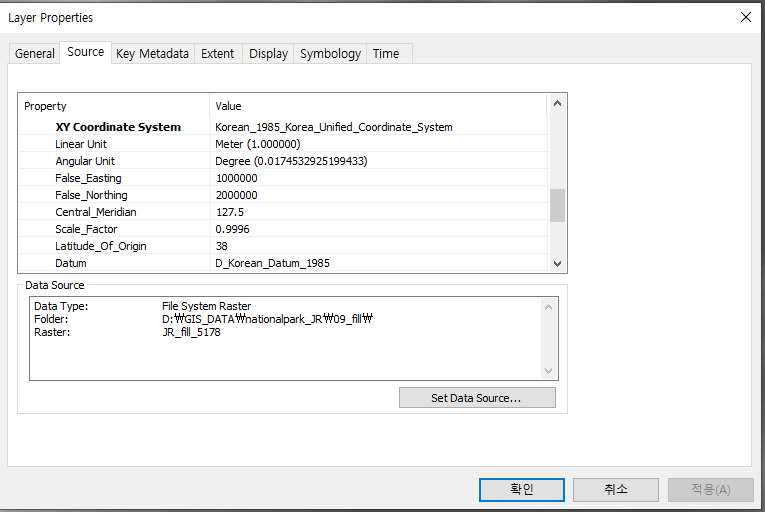

I would suggest that you also share a screenshot of your Raster Information for the current raster layer. There might be crucial information that might tell a bit more of the problem.
Have you tried to export your raster to a different format like a GeoTiff or to a file geodatabase?
