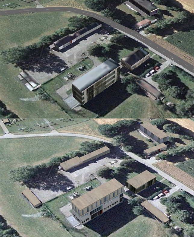

I'm using a CityEngine rule to texture building roofs in an area, using a single aerial photo. When I try to use the rule (exported as rpk with the aerial photo included) in AG Pro, the texture is being applied as far as I can tell, but not properly - it seems as if the same bit is being applied to every building. Since it's not possible to change the attributes of a procedural fill layer on a per-shape basis like in CE(?), does this mean that this texturing method can't be used in AGP?
(The projection's the same and meter-based).
Here's the relevant CGA:
RoofTextureFromBasemap -->
  setupProjection(0, world.xz, Map_Size_X, Map_Size_Z)
  set(material.colormap, Map_Path_Aerial)
  projectUV(0)
  translateUV(0, -Map_Offset_X/Map_Size_X, -Map_Offset_Z/Map_Size_Z)
  scaleUV(0,1,-1)
Screenshot(s), top CE, bottom AGP:

Interesting. I have not tried this before, but it might be that the global coordinate system in CE is defined differently than it is in pro...which would make some sense. Are you using a similar coordinate system between the two? Is the CityEngine aerial imagery you are using georeferenced in a similar coordinate system? (That may not even fix the problem because CityEngine does not really have conventional spatial references).

You can't sample the way CGA does in CityEngine. If you were sampling data, then you would use GP tools to get data from other layers onto the shapes you run the RPK on. But for sampling a terrain image, I don't know of any way to do that. There's a lot of things I don't know. But I do know SOH CAH TOA.

Nah, I'm sampling the aerial image used in CE. It gets packed up with the RPK. If I export the models as multipatch, the image is added entirely, once for each shape
