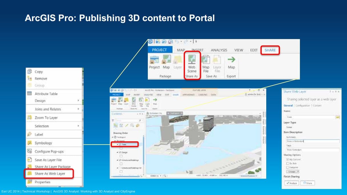

Most of you have probably seen the video/presentation where publishing 3D content to Portal is shown. It looks really cool and I think this is one of the things that we are missing in 3D-GIS.
I am so lucky that I got to test the pre-release of 10.3 and ArcGIS Pro. So my question: To be able to publish a 3D-service to my portal it says in the documentation: "All scene services begin inside ArcGIS Pro where you author a 3D scene. When you've finished authoring and are ready to publish, select the desired 3D layers in the Contents pane, right-click, and choose Share As Web Layer" This is also shown in the presentation from UC2014: wabLayr.JPG

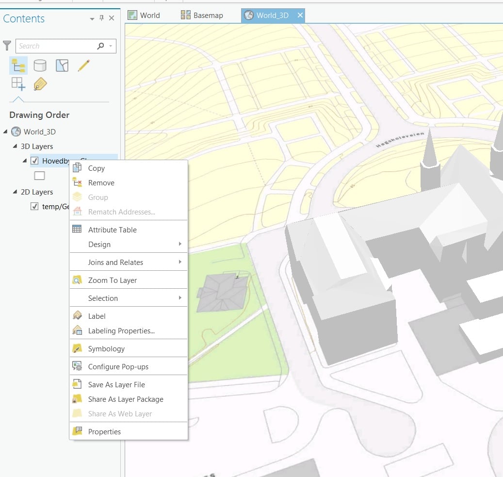

Here we see that when you right-click the layers under 3D-layers you got the option Share as web layer. Here is what happening when i'm doing the same thing:
As you see the option is grayed out. I am trying to publish a multipatch, is this the right format? because it's realy looks like Gert and the crew are publishing multipatches in the presentation (first screen-dump).
