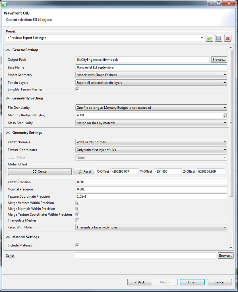

Everything goes well until "export models"

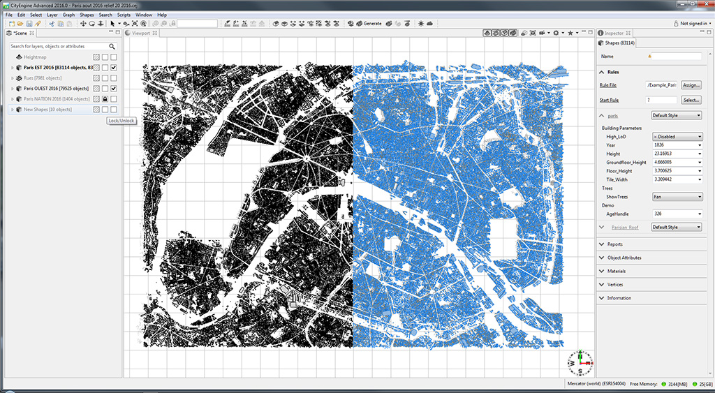

I divided the scene into several parts (6)
Export works very well with 5 of them

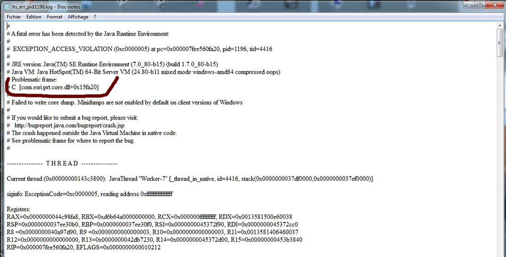

As against the sixth named "Paris Est" CityEngine suddenly crashes and closes without finishing the job. A "log" file appears on the desktop. (attached photo)
I of course tried several tries, cut the scene in a different way; nothing to do there is something in this area that causes the crash.

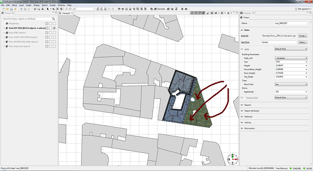

A little research, I realized that this is a group of polygons that problem.
As soon as I change the "rules" of these polygons, export proceeds smoothly
Why these three polygons they refuse to be 'lots'? It crash!
If they are "garden" it works ...
What are they special?
