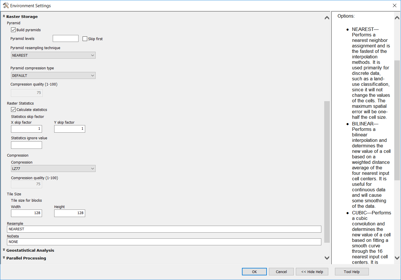

ThomasL
Thank you Dan!
Under Raster Storage I fund the Resample setting:
As I understand your link I will need to add the following line to my code to:
arcpy.env.resamplingMethod = "BILINEAR"
Perfect!
