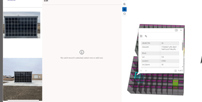

I am trying to create a Columbarium Data entry app.
I created a scene layer to achieve the columbarium block, then I used fishnet to generate polygons in a Multipatch to represent the Columbarium Niches. Then I copied the fishnet polygon layer and add it onto the block. This gave me a good representation of the Physical Columbarium.
Now I was able to publish the data to ArcGIS Online and Portal, but it is not allowing me to edit the niches. I am able to edit it in ArcPro.
I understand that I need to add the Feature layer onto the Scene map but each time I am getting an error stating that "MultiPatch is not supported" I am also aware that Scene layers are not editable but what I don't understand is why I am not able to add the feature layer that was published along with the scene layer onto the web scene map. Here lies my constraint!!
I really need help at this point. Please see a screenshot of the Webscene below
BobBooth1
You might be able to make the boxes using a point feature layer, symbolized using a cube symbol, and use editing tools or Survey123 to edit the points.
IreneEgbulefu1
The issue here is that I am using the map inside an experienced builder. I am not using survey 123
