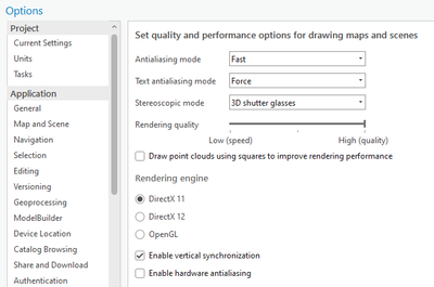

After updating to ArcGIS Pro 3.3, the program began to hang when closed and has to be force crashed or ended in task manager.  This was not an issue on any earlier version. Even left overnight, the program will not complete the close process and remains stuck open but inoperable.
After a little trial and error, it rests on having the Options --> Display --> Stereoscopic mode set to "3D shutter glasses."  This setting, mandatory to our workflow, has worked fine on previous version.  The only current work around is to turn Stereoscopic mode to "Off" prior to exit or force crash the program after saving and closing.
3D shutter imagery still works without issue in ArcGIS Pro 3.3.

Hello @Astrassman , I tried this and it seemed to work without any problems for me. Please can you confirm if you still see the problem when using ArcGIS Pro 3.3.1 ?
