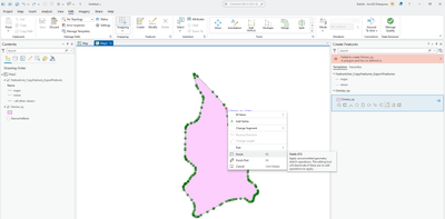

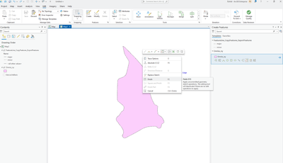

Åshild_L
I experienced this error message when finishing the trace sketch before I created an endpoint for the sketch. The sketch needed to be showing the vertices before right-click Finish or F2:
