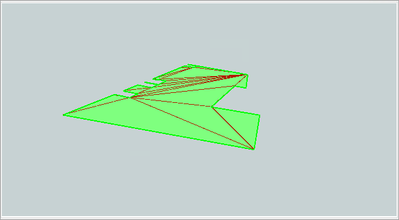

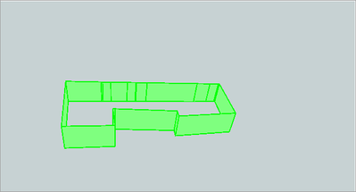

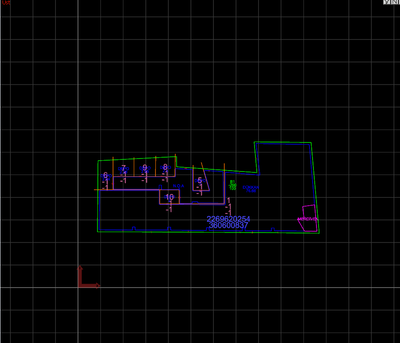

While taking a look of your data, I found there is no 3D Solid or Mesh in your 3D CAD file, they are polylines and polygons with Z value. If you are exporting a file without any 3D elements, an empty IFC file will be generated. Try create a solid or mesh and export again. Hope that helps.
