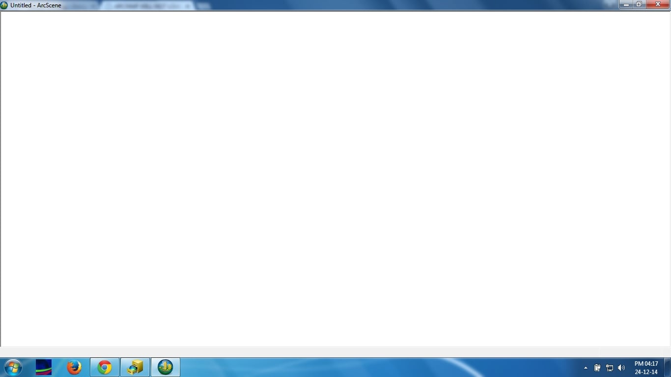

I have installed ArcGIS 10.2.2 on my Windows 7 SP 1 system. Only ArcCatalog opens but arcmap is not loading past loading document screen. The application exits by itself without giving any error report or anything at all. It just disappears. I tried to rename the HKEY_CURRENT_USER\SOFTWARE\ESRI key but it did not help. ArcScene and ArcGlobe are opening but it shows no toolbar or extension, just a blank windows opens up. I'm inserting an image of arcscene window. Please see the attached images of arccatalog and arcglobe also. Please help. Thanks.

First of all I would like to thank you for your kind reply. I tried changing the extension, but it did not help. When I launched arcmap, new same template is again created. It's not a template issue. The arcmap starts, shows initializing application, then loading document and then before the window could open, the application exits by itself. Would restoring my windows to a previous time, when arcmap was working fine, help? Or is there anything else that I could try first?
