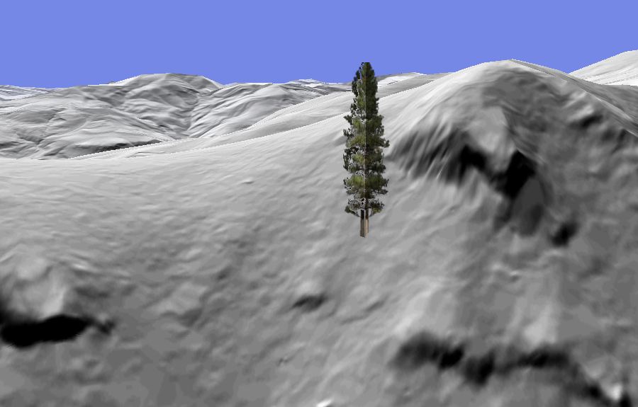

Does anyone know how to either edit existing 3d trees available in the 3d trees style set, or create my own 3d tree models to use in arcglobe and or arcgis explorer?  I am using arcgis 10.2, and arcgis explorer build 2500 to do forestry visualizations, and none of the tree models are realistic for the tree types i want to visualize.  I have several photos with alpha channel transparencies i would like to use to create the tree models but cannot seem to figure out the process for creating them.  I have access to adobe CS5.5, autocad civil 3d 2012, and could probably load other freeware if there is a good method for creating these models.  I just really want a simple 2 or 3 plane tree model with material draping from the photos i have.   any help on preferred software, process and file type ect that will work for making the marker symbol similar to below:

Thanks for the response!  I appreciate the info.  I have scoured the 3d warehouse for something that would work and have found nothing to fit my need.  The stuff that has been close, is generally to complex to use for large scale visualizations.  I am hoping to use this over relatively big areas so i need a simple model.  I have done a lot of playing around with this  and have had pretty good luck with making my own 2d (Front facing) marker symbols, they look really good from oblique angles but they start to get funny when doing fly over type scenarios where they always "face front" and you don't get a down facing perspective of the trees.  So, follow up question is it relatively easy in sketchup to take the tree photo i have, create a two or three plane model and attach the photo i have to to the planes and save it as a collada file (.dae)  I have tried this in adobe photoshop and cannot quite get it to work..  If seems like it should be a simple task, but i'm no expert with photoshop, and have never used sketch up.  Here's some example of my dilemma below
They look pretty good looking from oblique angles........
But get funky when flying overhead sometimes.....
