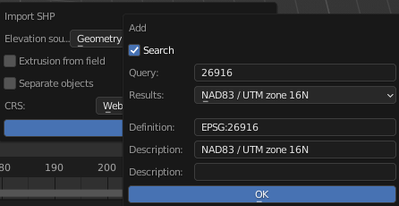

I am using blender along with the GIS plugin. You should be able to load the points into blender, but do make sure choosing the correct reference system (NAD1983 UTM Zone 16N, for example) when importing.

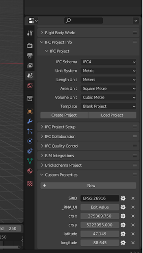

Once imported, the points should be displayed in the middle of the view port since blender does not handle huge numbers well, but there will be a shift in x and y and you can find that information in scene properties tab->custom properties.

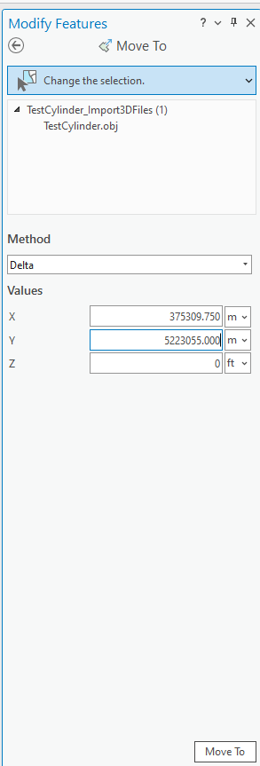

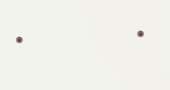

Import the model into ArcGIS Pro and the model should be in somewhere weird. I don't recommend zoom to layer at this point but instead, you can open up the attribute table of the multipatch and select the models. Go to edit and select "move to". From there you might want to use delta instead of absolute and then you can put the shift in x and y in there and your model should be really close to your points (my PC is a potato so I have to use 2D view). I usually just stop right here since my purpose is just visualization but if you need it to be really accurate, you can always make adjustments in ArcGIS Pro.
To be honest I don't think this is an easy way but it works for me most of the time and I hope it helps.
