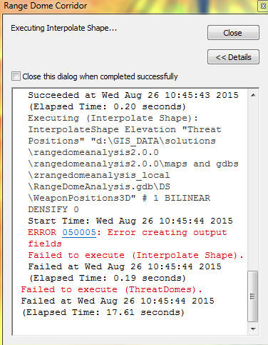

Has anyone of you used the range dome analysis template? I am trying to understand and use this template. I followed the instructions given in the solutions website about setting up the template. However when I run the analysis I keep getting the ERROR 050005 (See below).

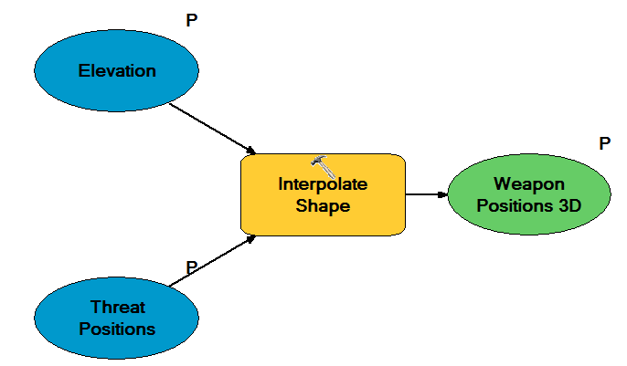

I checked the modelbuilder to look for any broken connections, re-run the model again and got the same error. So then I editted  the model and kept the section that was causing the error, which is one of the first steps in the model (see below). I run that small process and got the same error message.
So if any of you have worked with this template and have been able to use it, I would appreciate your insights on this issue.

Hi again,
So I created a new geodatabase instead of using the RangeDomeAnalysis.gdb. Then before running the model, I made sure the output path is set to the new gdb I created. I run the model and it worked.

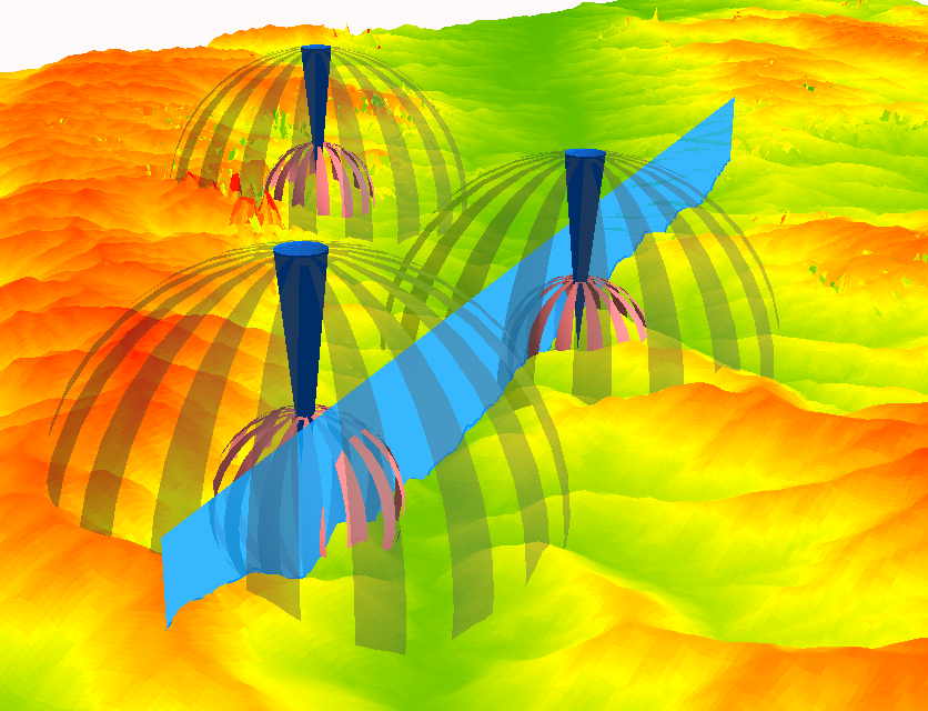

I still dont get how in the video the air corridor has different elevation values (it goes up) (top image), while mine has the same height all the time (bottom image). It stays at the same altitude...maybe there is something else I need to do, or thats not how flight corridors work
