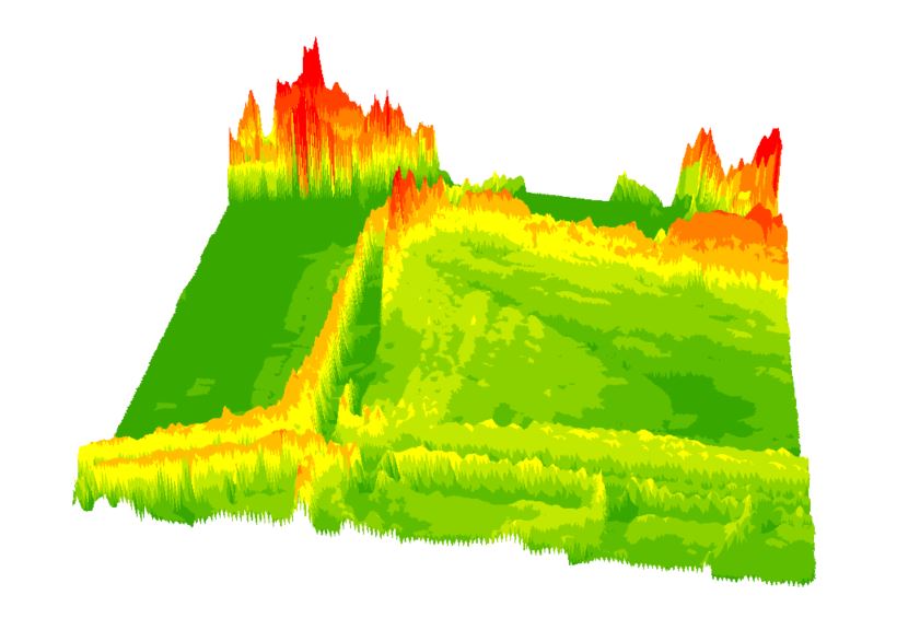

Thanks..,do you have any experience with Aspect and Slope; in ArcScene the results are not quite intuitive:
