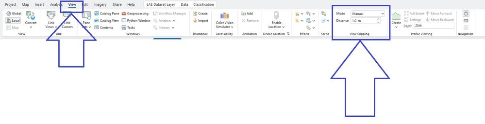

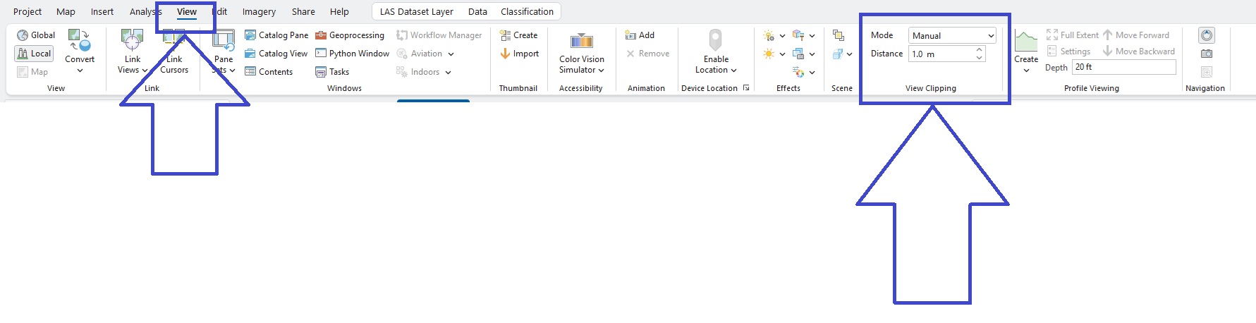

Derrick_Westoby
Regular Contributor
I just answered the same question in another thread. Here's a copy and paste of the same answer-
Are the points always in the foreground?
View tab -> "view clipping" ->change mode from automatic to manual and set the distance to something like 0.05m or 1m.
I assume that's what you need, but if that doesnt fix the issue:
