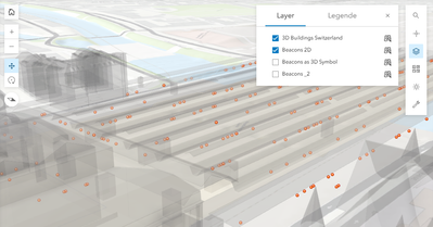

2D Layer Features, symbolisced as 2D Marker, Relative to ground or relative to scene, are not showed when they are inside or behind a 3D-Object (Scene Service, like a Building).
Tranparency on the 3D-Object makes no difference, exept 100%.
Workaround: 2D Layer as Style 3D-Object
Any plans, that the 2D Symbols are also showing up, if behind 3D Objects? This is important for indoor sensors, Beacons, Analytic-Points (Noise, Visibility and more)

ArcGIS Maps SDK for JavaScript 5.0 introduced improved occlusion handling for 3D labels and icons. Labels and icons can now remain visible when occluded by buildings, floors, or terrain, making it easier to work with indoor sensors, beacons, and analytical points in complex 3D scenes.

Thanks @ThomasKnabl Looks good! Same Scene as before, the Icons are shown now
