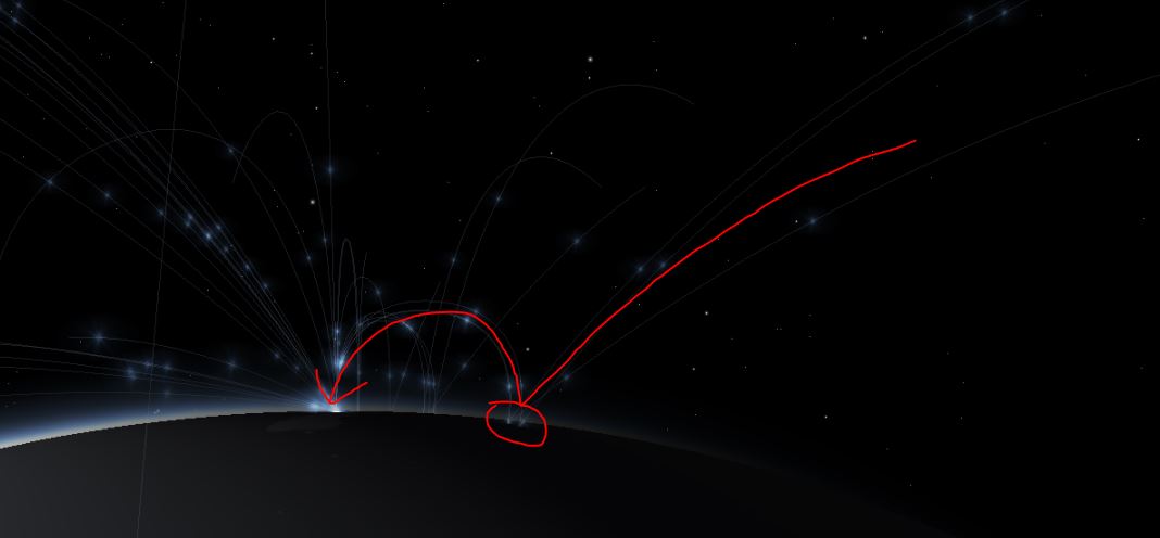

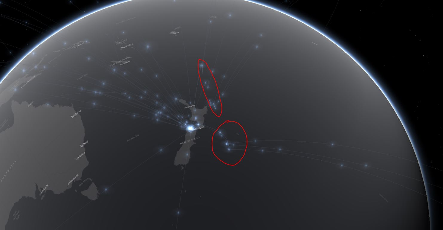

Hi all,
I have following problem:
I'm trying to display international visitor arrivals to New Zealand with a 3D scene and the 3Dfx widget.
However, lines which are crossing the International Date Line are not visualised correctly.
It looks like the lines are stopping at the IDL.
Any ideas how I can fix that?

Marco, thanks for the sample app and data. The challenge is when a line goes from a point in Japan to another point in US, for example, we don't really have a way to know that it is meant to go via the Pacific Ocean or via Europe. We don’t “automatically” pick the shortest distance.  Instead, we assume that the data has been normalized correctly. To workaround, you may try the followings:
1. Provide the data in a way that indicates “across dateline”.For example, by adding 360 degrees to put in the “next” world, ie, instead of using
paths: [
[-119, 33], // US
[117, 40] // China
use
paths: [
[241, 33], // US <!-- Note the “241”!
[117, 40] // China
Once the data is like that, you can “normalize” it using
https://developers.arcgis.com/javascript/latest/api-reference/esri-geometry-support-normalizeUtils.h...
