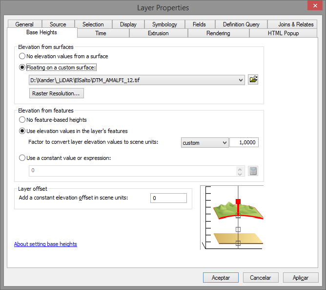

You don't have to display your DEM to use the DEM as Elevation data for you vector layer, using the option "Floating on a custom surface":
JenSchmidt
That works too and I like that I can lay it flat and see the colder areas are greater in elevation.  I will have to investigate why I do not get the option to check "Use elevation values in the layer's features".   Thank you this is really powerful.
