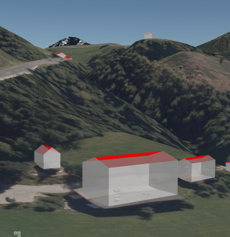

My data starts out in CityEngine and there I align it to elevation/terrain that I obtain from ArcGIS Online. By a rule I extrude and texture the elements and then to explain create Multipatches from it (exporting to a Scene layer right away does not do anything different in the result.
When I load this data into an ArcGIS Pro Scene, it does not align with the Ground. So my first assumption:
  • Global terrain used in Pro IS NOT identical to the terrain I can download from in CityEngine 2017 ???
This is how it looks like after loading it in Pro in an area that is rugged:

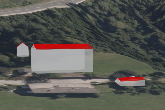

In Pro it is easy to fix that - just change the elevation settings to "on the ground" ... and here you go!

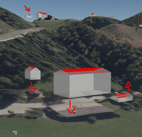

Now I can create a Scene Layer Package from the data (as mentioned above  -I could create that Package from CityEngine - but that does not behave different) and upload to ArcGIS Online. Not many settings there ..and the result is:
So I am back to the version with Terrain mismatch!
