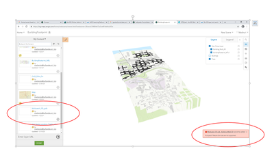

I am getting this error:

From the Multipatch feature layer item details page you should see a publish button and click Publish > Scene Layer. This will create the 3D Object scene layer.  You can also check on the feature layer that it shows Multipatch geometry and on the data tab there are feature records returned.
