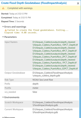

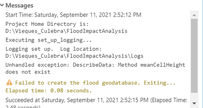

CesarPiovanetti1
@Gert_van_Maren
Hello sir! I am using the tool but I am getting an error when creating the GDB using the Create flood depth geodatabase tool using the Task workflow or the tool from the provided Toolbox. Any assistance will be appreciated.
ErnestoCarreras2
I am experiencing the same issue described above when trying to create the flood depth geodatabase.

Gertvan_Maren1
Esri Alum
Hi Ernesto,
Your depth data is multi-band RGB. You need a single band raster to run the tool:
- Create a single band raster from multi-band
https://support.esri.com/en/technical-article/000013385
Also you will need to set all zero area to Null using SetNull GP tool.
Let me know if this worked for you.
Regards Gert
ErnestoCarreras2
Thanks for pointing that out. That was the issue.
