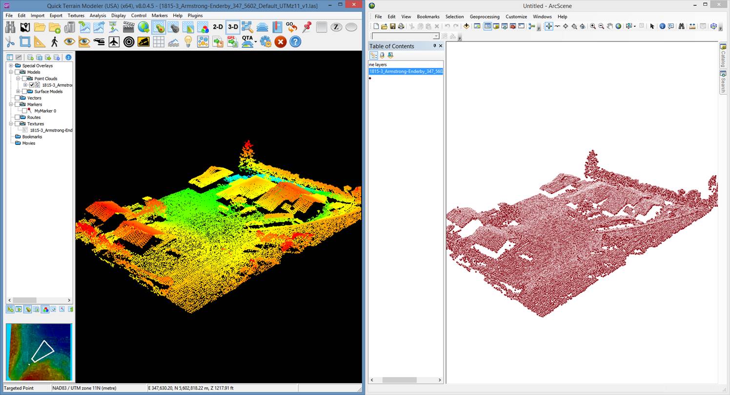

So apparently I was originally on the right-track to export the points with within QT Modeler using the 'Export Model(s)' menu.  It went awry for me when I did not first highlight the model that I wanted exported, honestly I didn't even know I was supposed to interact with the window (must not have been paying attention yesterday).  I sent this to our friends at Applied Imagery and Mike replied with the message below.  Thank you Mike, I appreciate your continued support.
From: Mike @ appliedimagery.com
Sent: Wednesday, May 06, 2015 11:47 AM
To: 'Matthew Duffy'
Subject: RE: Point Export
Matt,
I just tried and it worked well
for me.  Here are my steps:
  1. Load point into QT
    (in your case, import and filter for class 2 (not return 2))
  2. Once loaded, use
    selection polygon to draw your area of interest
  3. Then, click the crop
    button on the toolbar (blue square)
  4. Now, go to EXPORT
    > EXPORT MODEL DATA – choose ESRI SHAPEFILE SAMPLED 3D and make sure the
    point cloud file is highlighted as shown below
  5. Once exported, the
    resulting 3D shapefile can be opened directly in Arc products (image of QT and
    ArcScene with loaded data below).
Regards,
Mike
www.appliedimagery.com
MatthewDuffy
Rather than export to ASCII text file, use the Export Model (either top menu or right-click on model), export to ESRI Shapefile Sample 3D.  This will reduce the above process by a step, unless you need the output to be a feature class opposed to a shapefil
