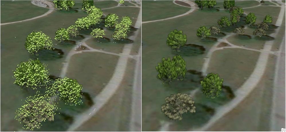

The November 2020 solution release sees the first integration of deep learning into the 3D basemaps solution. Leveraging a new tree classification deep learning model on the Living Atlas, it is now possible to classify trees in lidar point clouds in ArcGIS Pro.
Before and after using deep learning to classify trees in the lidar point cloudBefore and after using deep learning to classify trees in the lidar point cloud
