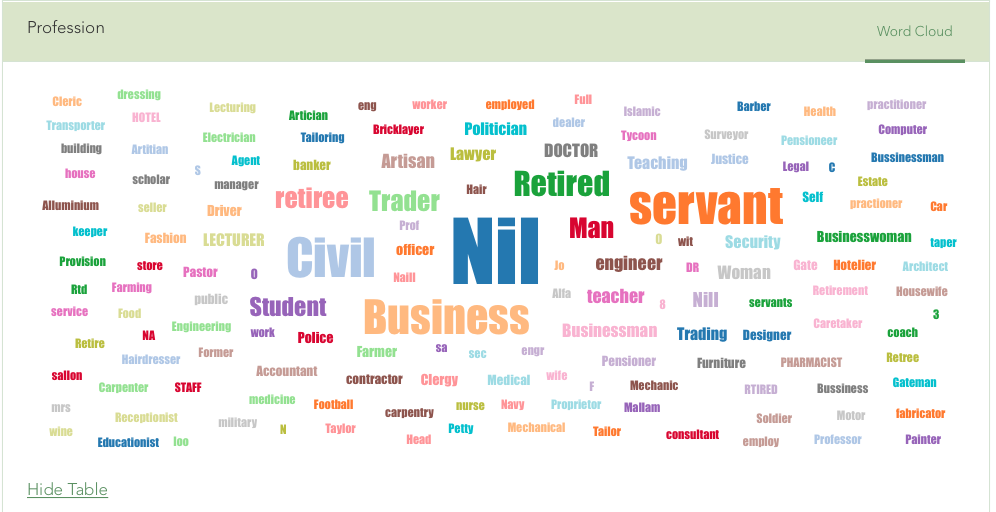

- Text (free text): The most common words by count will be displayed as a word cloud (requires at least 20 entries)

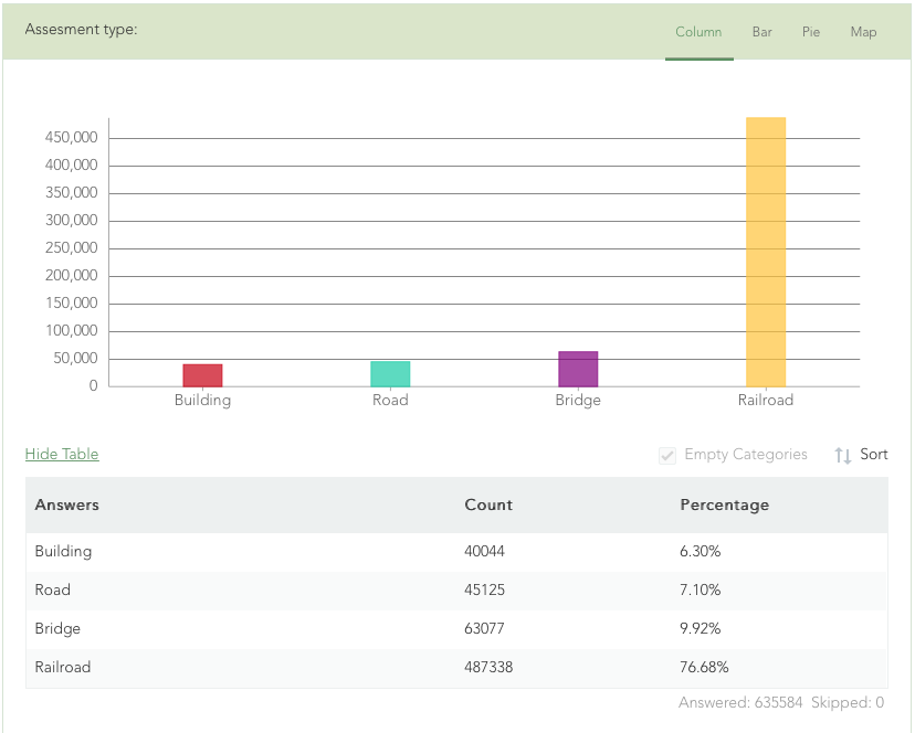

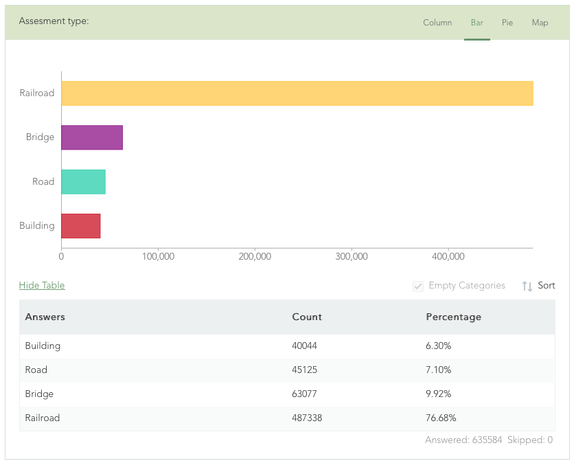

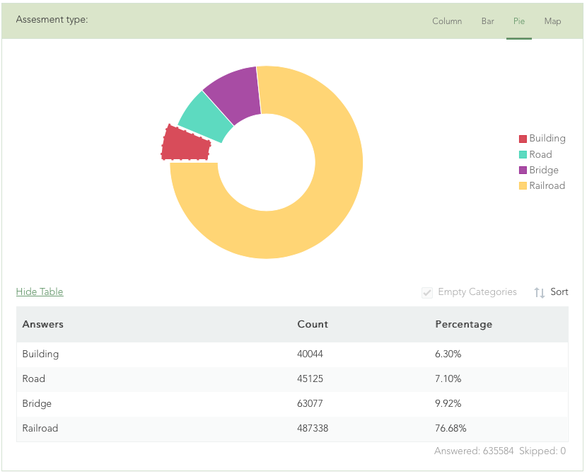

- Single Choice Questions: Column, Bar, and Pie charts, as well as a map color-coded by answer

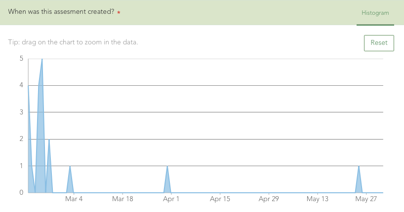

- Date questions: Histogram

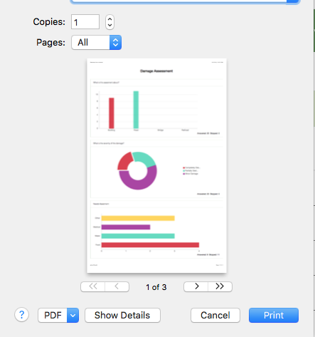

From the Analyze tab, you can print your entire survey summary results as a PDF file. You can alternatively hide questions from your report using the 'Visibility' setting. When ready to print, use the 'Print Current View'; if your browser supports PDF generation, you can then save the result to a PDF file.
With the latest update to the Survey123 website we also have enabled the printing of individual responses. In the 'Data' tab is now the option to view the details of a response. From there you can print that detail or save as a PDF file.
