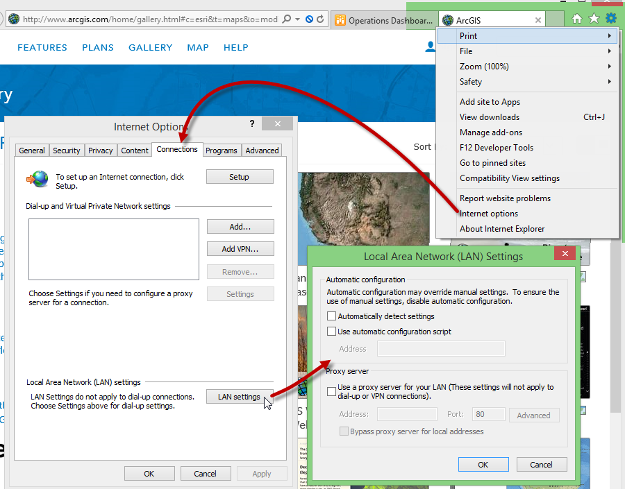

It sounds like the ArcGISConnectionBin.exe is not running correctly.  This is known to be a problem with Windows 7 and Internet Explorer 10.  Some have found that they can resolve the issue by un-checking 'Automatically detect setings' in Internet Explorer Options - Connections tab - Lan Settings.  Others have had to work with their IT department to make adjustments to Proxy Server settings.
So far we have not heard of anyone having this issue with Windows 8.
graphic explanation of the above:
[ATTACH=CONFIG]30187[/ATTACH]
updated with image

Was again having the jumping clicker problem with Windows 8.1 in ArcGIS Explorer Desktop 2505.  After reading this post I took a look at the ArcGISConnectionBin.exe and changed it to run in Windows 7 compatability mode.  That stopped the jumping cursor issue.  For now... PS... the attachment in this content is mostly blank so not sure what that was for.  Thanks for potentially pointing us in the right direction.

I've been dealing with that problem for months and now it's working great..I can't thank you enough!
