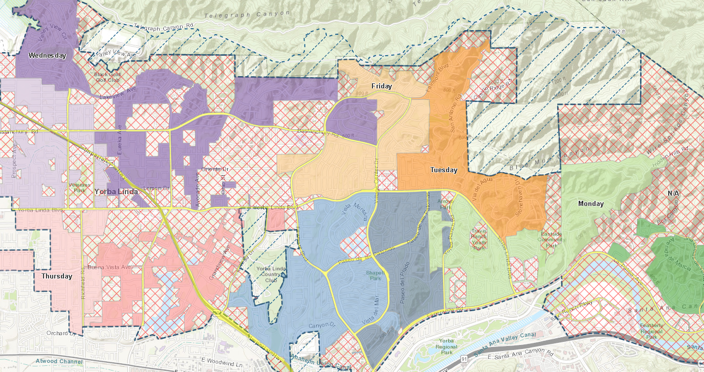

I have a map image service for street sweeping. Each day of the week has two areas that are swept on alternating weeks. I create a custom Arcade expression [DomainName($feature, 'SweepDay')] to label the Domain value, not code. The proper day is labeled but for only one feature and all duplicates are removed. Can I change the expression or change something else to label each feature and not remove duplicates? The Yellow and Blue should be labeled Friday, purple shades are Wednesday, pink/red for Thursday, etc. Only one label is present instead of two or three depending on the day of the week.
