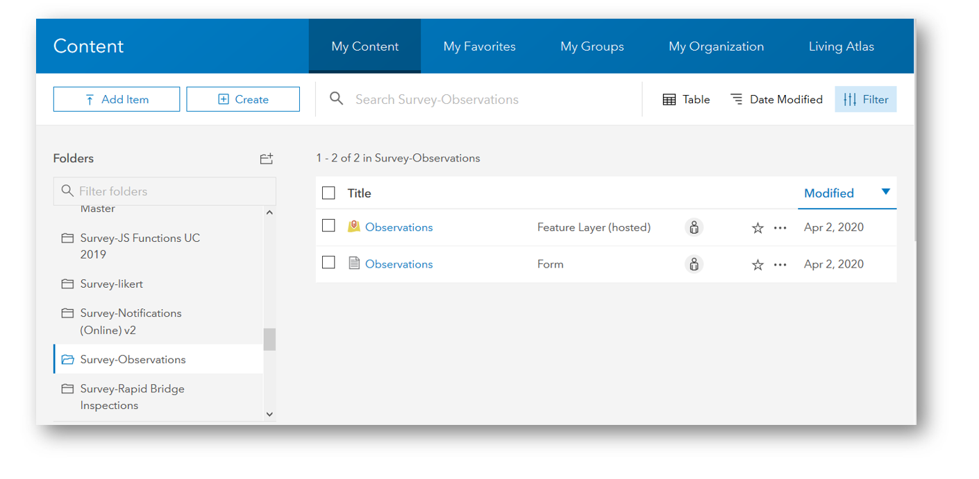

To properly secure your survey results it is important to understand first some basic concepts. When you publish a survey using Survey123 Connect, a new folder is created in your ArcGIS account. This folder includes the name of your survey so you can easily find it. Inside this folder, you will find a Form item and a Feature layer item:
- Form item: The Form item contains the definition of the questionnaire presented to users: The labels of your questions, the calculations, media files and other resources needed to render your form.
- Feature layer: The feature layer is the item where responses to your survey are stored.
In short, the survey folder contains one item (the form item) for the survey questions and one item (the feature layer) for the survey responses.

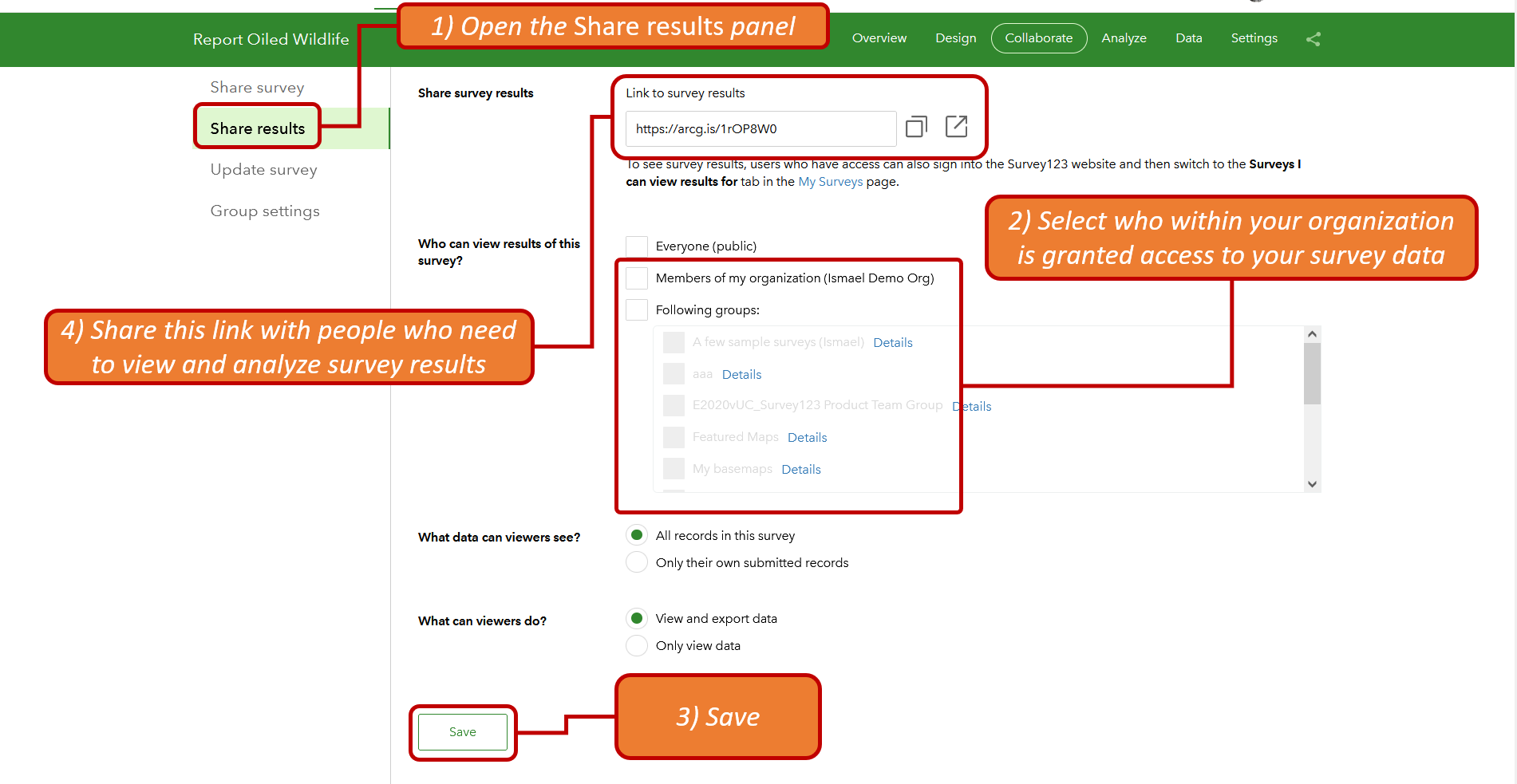

- Switch to the Share results panel, select who should have access to your survey results and what privileges you want to grant to these users. Click Save.

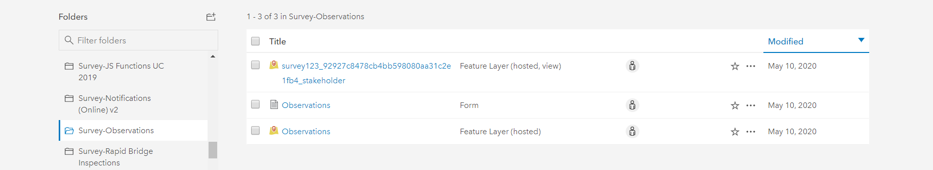

If you return now to the Survey123 folder under Content in ArcGIS.com, and refresh it, you will notice that a new view has been created for your survey. This view has a 'stakeholder' suffix.
This new view will control who can use the Survey123 website to look at your survey results. You will want to use the Share results panel in the Collaborate tab of the Survey123 website to control this. For example, say that users in a group called 'City of Cilantro' need to be able to look at the results of your survey, create reports and download data. Then you will go into the Collaborate tab, switch to the Share results panel and share your survey results with that group. At that point, 'City of Cilantro' users can log into the Survey123 website and use the Overview, Data and Analyze tabs to do what they need.

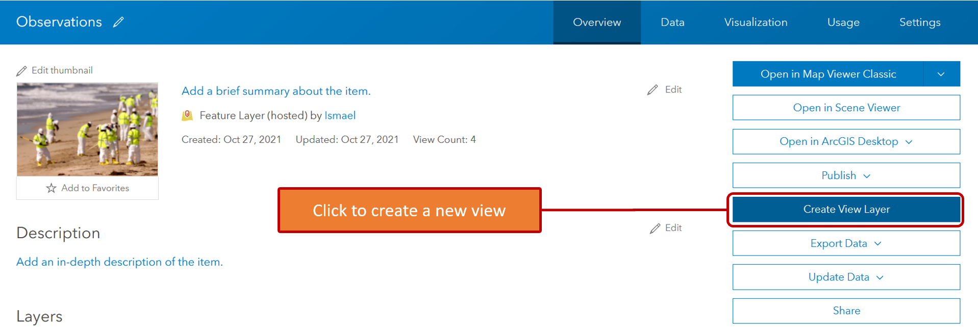

- Look for the Layers section and click on your survey feature layer link. This will open the item details page for your surveys feature layer.
- Click on Create View Layer. You can choose any title for your feature layer view.
- Go into the Settings tab
- Enable Public Data Collection and save.
- Make sure Enable editing is checked and save.

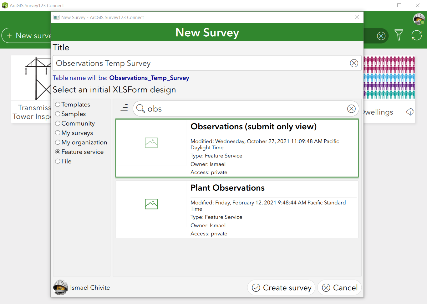

- In Survey123 Connect, from the survey gallery, click on New Survey and then choose the Feature Service option.
- Look for the feature layer view you just created and give your new survey a throw-away name, such as temp or delete_me.
- Open the XLSForm of your temporary new survey and switch to the settings worksheet. Then copy the values in the form_Id and submission_url cells into a text editor or a safe place, so we can paste them later into the original survey.

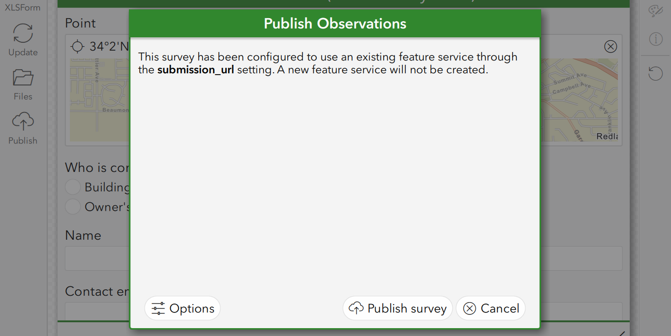

- Save your XLSForm and publish your survey again.
The Publish dialog will indicate that your existing survey will be updated to use a custom feature service as specified by the submission URL, as shown in the next screenshot.
Now that your survey has been updated to target your own feature layer view, you can share your survey publicly with confidence. We will do that from the Survey123 website.

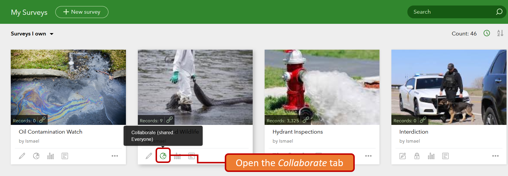

- Log into the Survey123 website at survey123.arcgis.com.

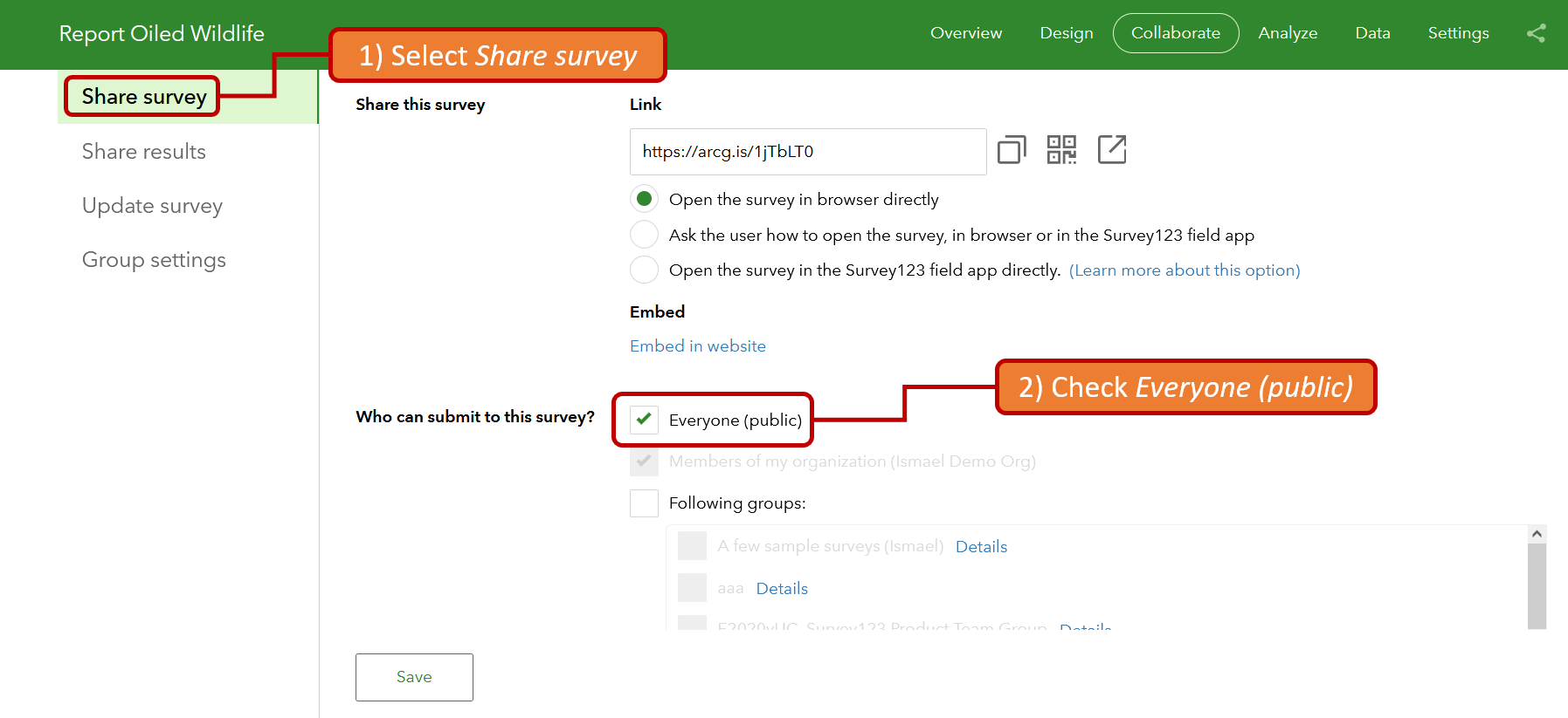

- From the survey gallery, open the Collaborate tab of your survey
- The Share survey panel controls who can submit data to your survey. While in the Share survey panel, look for the section named 'Who can submit to this survey?' and check the Everyone (Public) option to share your survey publicly.

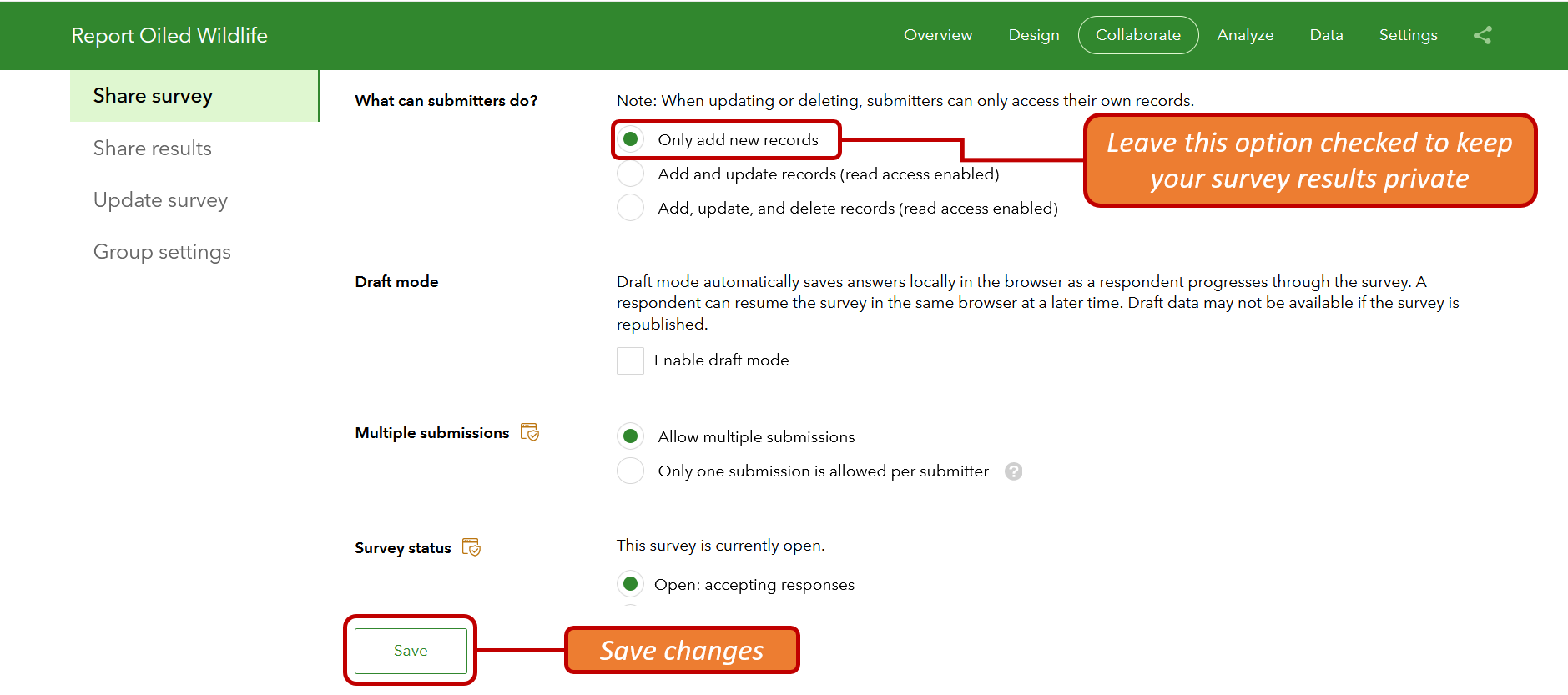

- Scroll down the page and look for the What can submitters do? section. Note that by default, the selected option is 'Only add new records'. This guarantees that your survey layer will not expose your survey results.
- Click on Save at the bottom to persist all changes.
At this moment, your survey is shared publicly, allowing anyone to submit data through both the Survey123 web and field apps. You can get the link to your survey from the top of the Collaborate tab and distribute the link with your users. Since you have restricted access to 'Only add new records' in the Collaborate tab, it will not be possible to query, update, delete or download your survey data through the Survey123 web or field apps. Your survey's feature layer will also be secure, preventing any type of access (other than adding new records) from other Esri apps, third party apps or programmatic access.
