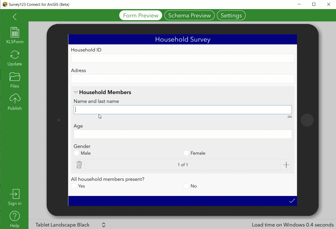

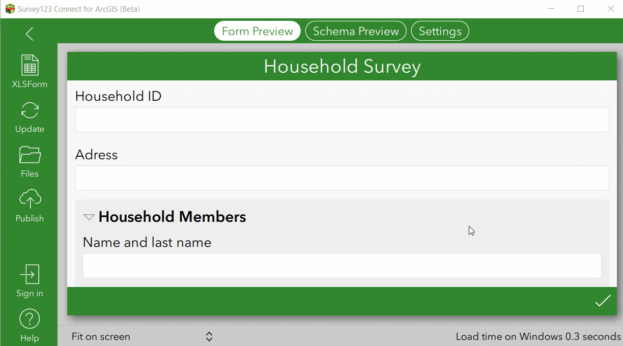

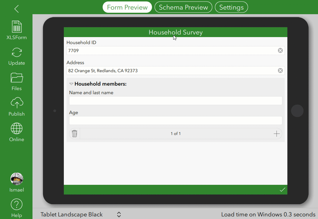

In the survey above, the main body of the form is really about the household itself and is used to collect the household ID and address. The repeat block is all about household member information. We expect the enumerator to complete the Household Members repeat, or sub-form, once for each person in the household. The All household members present? question is outside the repeat, so it also belongs to the main form, but it will be presented right after the Household Members repeat.
Below is what the survey above would look like in the Connect preview. Note that the repeat appears as a common question group, except that at the bottom there are multiple options to navigate records within the repeat: a plus button to add a new record as well as next and back buttons (once you have more than one household member).

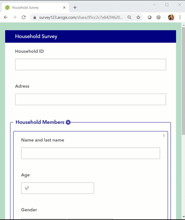

The user experience for repeats within the Survey123 web app is slightly different, presenting all the repeat records at once. You can navigate through them by scrolling up and down, as shown in the next animation.
You can add one or more repeats to your survey. For example, in a school survey, you could include a repeat to document all classes in the school, and a separate repeat to gather information about teachers, etc.

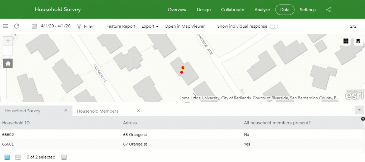

Understanding repeat data in your feature layer
Survey123 repeats are modeled in ArcGIS as related tables (or related layers if your repeat includes a geopoint, geoshape or geotrace question). In the example household survey above, the information about the household (id, address...) is kept in the main layer of a feature service, and the data from the household member repeat (name, age, gender) is modeled as a separate, but related table. The relationship between the tables/layers is kept through internally created global IDs.
If you would like to preview what your geodatabase schema looks like you can use the Schema Preview option in Connect, as shown in the animation below. Note that the name of the repeat in XLSForm becomes the name of the related table.
Using the Survey123 website, you can quickly explore data from repeats using the Data tab. The table will show records from the main layer of your survey as usual, and also extra tabs for every repeat in your form. You can propagate selections across the tabs for easier exploration of your data.

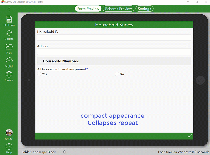

Repeat appearances (minimal and compact)
Through the appearance column in the XLSForm you can control how the repeat initially loads and appears in your form. By default, a repeat with no appearance value set is shown expanded, with one initial record showing. This can be good or bad. The good is that all questions within the repeat are ready for end-users to enter data right away. The bad is that if no data is entered, a new empty record will be added to your related table. I generally avoid using repeats with no appearance unless questions within the repeat are flagged as required.
If you want to avoid the repeat from having an initial record preloaded, use the minimal appearance. This will show your repeat group expanded, but with no records. To initialize data entry in the repeat, the end user will need to explicitly add a new record to the repeat by clicking the plus button.
The compact appearance simply collapses your repeat when the form initially loads. Of course, you can combine the minimal and compact appearances.

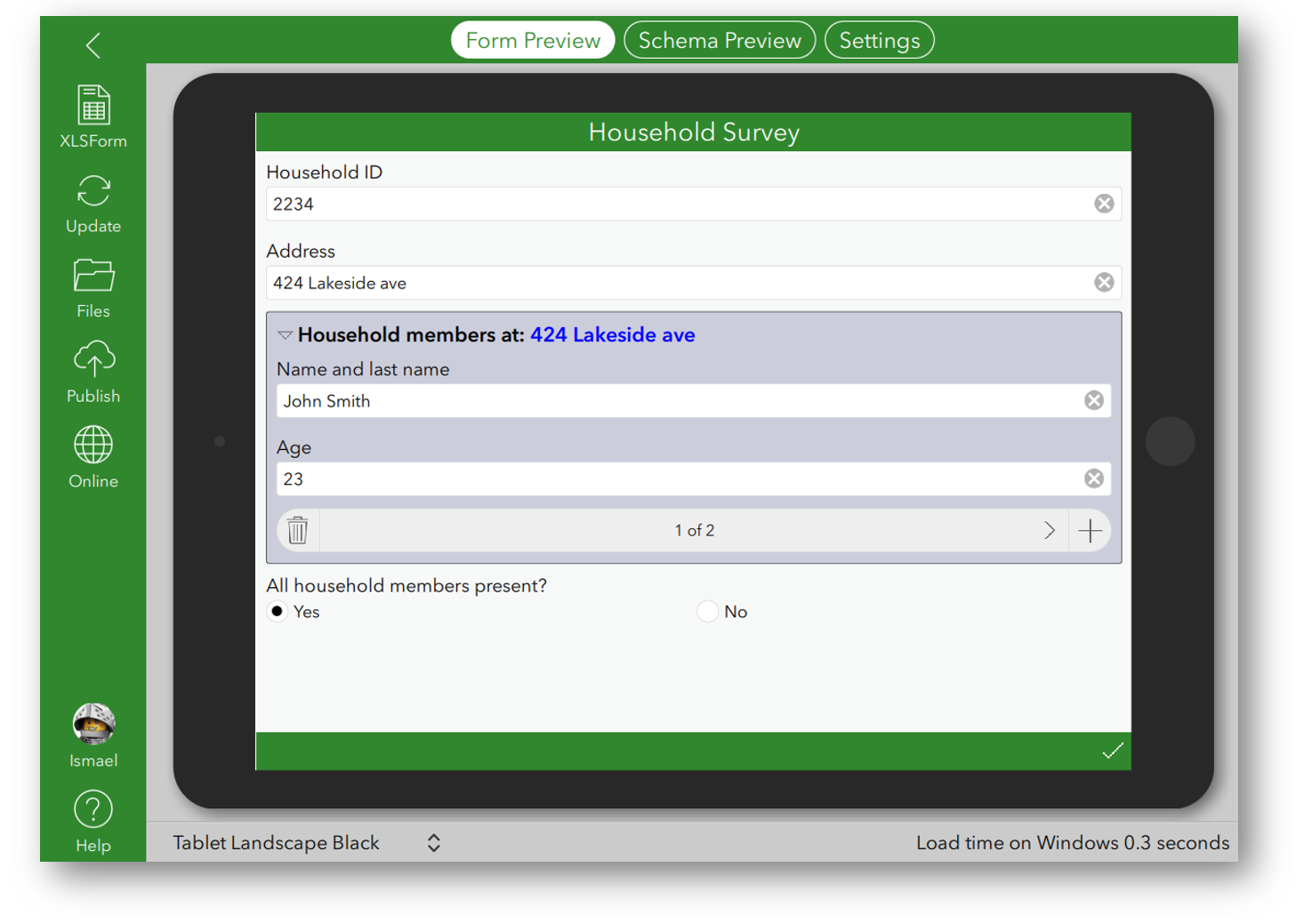

Styling
There are a few techniques you can use to style your repeat with custom colors and labels. This can be help users navigate your form more efficiently.
One technique is to dynamically set the label of your repeat to provide some context as to what information should be entered into the repeat. For example, in our household survey, you can include the address of the household in the header of the repeat. Instead of just reading 'Household Members', you can make it read 'Household Members at: <Address of the household comes here>. This is what is known as a dynamic label and it is described in more detail in the https://community.esri.com/groups/survey123/blog/2018/11/01/understanding-dynamic-labels-in-survey123-for-arcgis blog post. This is quite handy when working with long surveys, because it brings additional context for the person filling out the form. Here is what this would look like. Note how the label for the repeat is dynamically generated using a value from a question outside the repeat.
| type | name | label |
| text | hh_address | Address |
| begin repeat | hh_members | Household Members at ${hh_address} |
You can also use colors to make your repeats stand out better within the form, like in the following screenshot. The repeat block uses a darker background color than the rest of the form, clearly separating questions within the repeat, from those outside.
The background and border colors of your repeat can be controlled through the body::esri:style column. In the example above, the vale in this column for the begin_repeat question is: backgroundColor='#cbcddb' borderColor='#494a4f'. The color is expressed in hexadecimal format or HTML color name. You will generally not want to use bright colors for you repeat backgrounds. Try to be subtle using slight variations of the background color of your form.
The body::esri:style color parameters are only honored by the Survey field app.

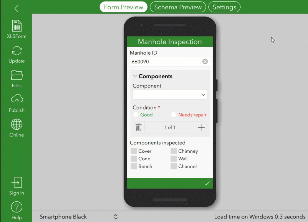

We can take join a bit further. Let's pretend we need to design a manhole inspection form. We want all six parts of the manhole to be inspected: the cover, chimney, cone, wall, bench and channel. We will use a repeat to document the inspection results of every component, and the join function to help us make sure all components have been inspected. Let's first have a look at what the form's behavior looks like:
Note that a checklist at the bottom of the form keeps track of the components inspected so far. When a new component is selected for inspection within the repeat, the value of the checklist is recalculated accordingly. This checklist at the bottom is set as read-only, so the user cannot manipulate it. A constraint in the checklist is also in place to avoid users from submitting the form unless all components are checked.
A simplified version of the XLSForm, highlighting the use of the join function is shown below:
