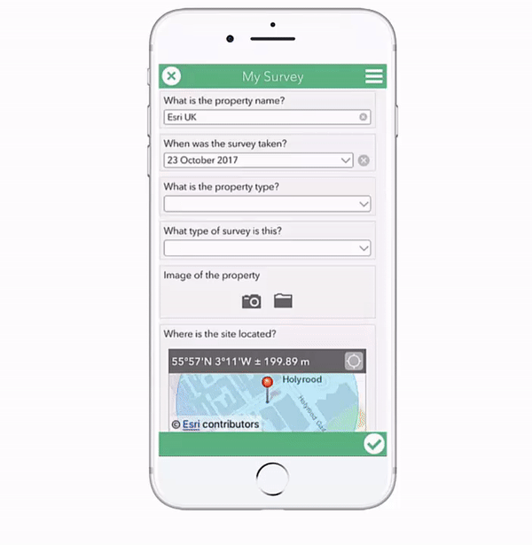

Survey123 is a very popular ArcGIS App for the Field and I'm always looking for new ways to work with it - to make sure it's delivering value for my users. Previously I've looked at applying a custom Other field and in this blog I investigate making survey results easier to analyse, or symbolise, when a survey includes the Other functionality.
If you're not aware, the Other functionality allows users to enter an Other value as an answer to a multiple choice question, if the answer they need is not in the list. This has been implemented for the question What is the property type?:
This functionality is awesome, but the Other value that a user inputs is assigned to a new field in the attribute table. This means it can be hard to analyse and query this question later on because the answers for one question are spread over two fields:
Here's a method to collate these answers to one field, making it easier for end users to view and query the data. So instead of the answers looking like the above example, they will look like this:
