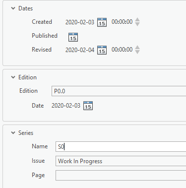

Now it strikes me from the layout metadata the obvious fields to want to access are Citation metadata.
Series seems like a good match for StatusCode
Edition seems like a good match for RevisionNumber
You can Access the Series name via
<dyn type="layout" property="metadata" attribute="series"/>
But this was undocumented behavior found by trial and error
but you cannot access the edition AFAIK via a similar method. Likewise being able to access the specific dates particularly the edition date would allow much of the map marginalia to be accessed from metadata.
