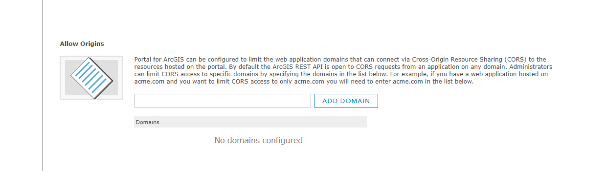

I can successfully open Web App Builder and create a project however only when I don't enter values in the Portals Security Allow Origins field.
This seems to be at odds with the following technical document https://support.esri.com/en/technical-article/000018879 that suggest that Web App Builder won't work unless your machinename.domain is added to the Allow Origins white list ?
If I add the domain name of the machine to the Allow Origins I get a continuous login redirect when I try to approve access to the portal.
I was going to add the following to the Allow Origins to restrict CORS requests - my domain e.g. https://xyz.com
any machines that have web app builder installed https://machine1name.domain https://machine2name.domain?

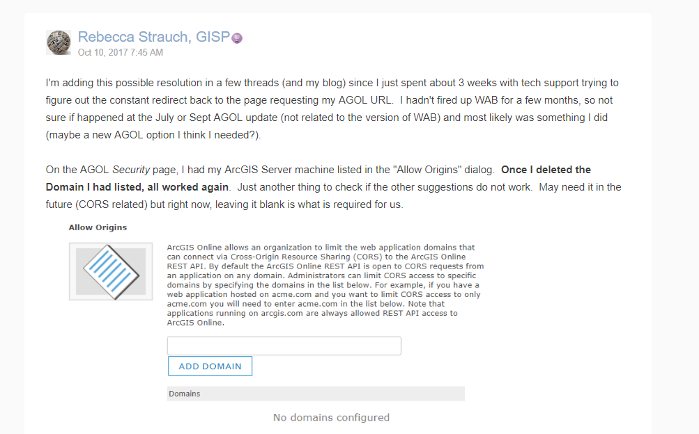

Rebecca Strauch, GISP you did you ever add Allow Origins to AGOL as per this thread https://community.esri.com/thread/175351?
