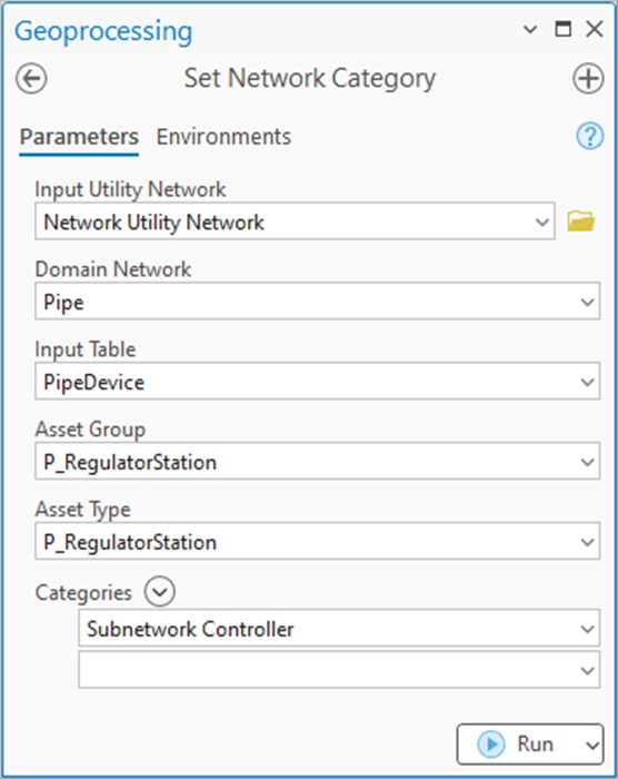

- Assign a network category

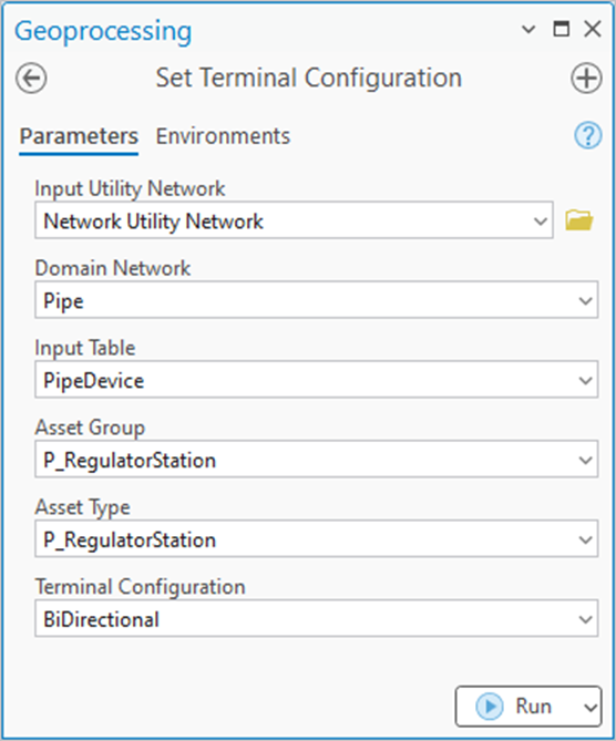

To start, we need to assign a terminal configuration to the asset types we want to be assigned as subnetwork controllers. When a line connects to a device with terminals, it must specify which terminal it is connected to. The ability to differentiate between connections is required when creating subnetwork controllers. As an example, without the use of a terminal configuration and terminal connections, a regulator would be unable to distinguish between the pipes connected to its inlet and the pipes being regulated connected to its outlet.
The Migrate To Utility Network tool includes three generic terminal configurations:
- Directional Source – This terminal configuration is used when a device in a source-based network needs upstream and downstream terminals.
- Directional Sink – This terminal configuration is used when a device in a sink-based network needs upstream and downstream terminals.
- BiDirectional – This terminal configuration is used when there is no explicit upstream or downstream terminal. It can be used in either source or sink-based networks.
Picking the right terminal configuration is important to ensure that tracing works properly. In a pressurized system, most network controllers have an explicit upstream and downstream terminal configuration. This means that water, gas, etc. can only flow from the pipe on the upstream terminal to the pipe on the downstream terminal. However, if you have equipment that can be configured to not regulate flow in the field you should use the BiDirectional terminal configuration which will allow pressure to be unregulated as it flows through the device. In our example, we will be configuring our device to be BiDirectional because several of our regulator stations maintain a high-pressure loop in our distribution system.

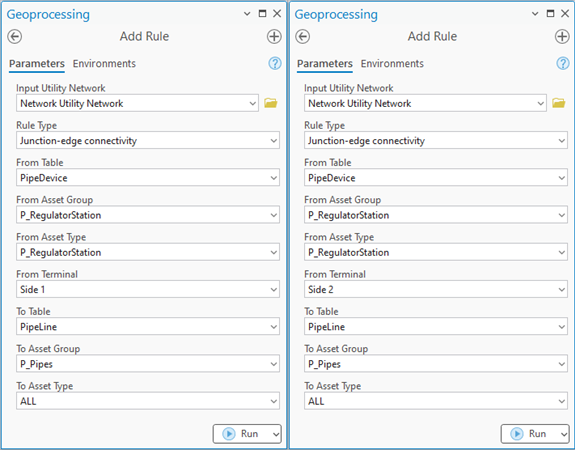

Once you have changed the terminal configuration of the device, you then need to create rules that allow you to define which types of pipes are allowed to connect to either terminal. In this example regulator stations have distribution pipes on both the inlet and outlet side of the device, so you will add rules for each side.
Note: When a pipe is allowed to connect to more than one terminal on a device, each pipe must specify which terminal it is connected to on the device. If it does not, this creates an ambiguous connectivity error that must be resolved using the Modify Terminal Connections tool.
If you were adding rules for town border stations or custody transfer meters, you would only allow transmission pipe to be on the upstream terminal and distribution pipe on the downstream terminal. If you are uncertain of which rules to add, consult with an engineer or someone else with an understanding of your system to help you make the right decision.
In the case of water models, pumps or pressure reducing valves would have distribution pipes on both the upstream and downstream terminals.

The next step is to define what kind of subnetworks the device is allowed to act as a subnetwork controller for using the Set Subnetwork Definition tool. The device should serve as a subnetwork controller for pressure zone subnetworks, but first a tier must be created to represent the pressure zones first. This is done using the Add Tier tool.

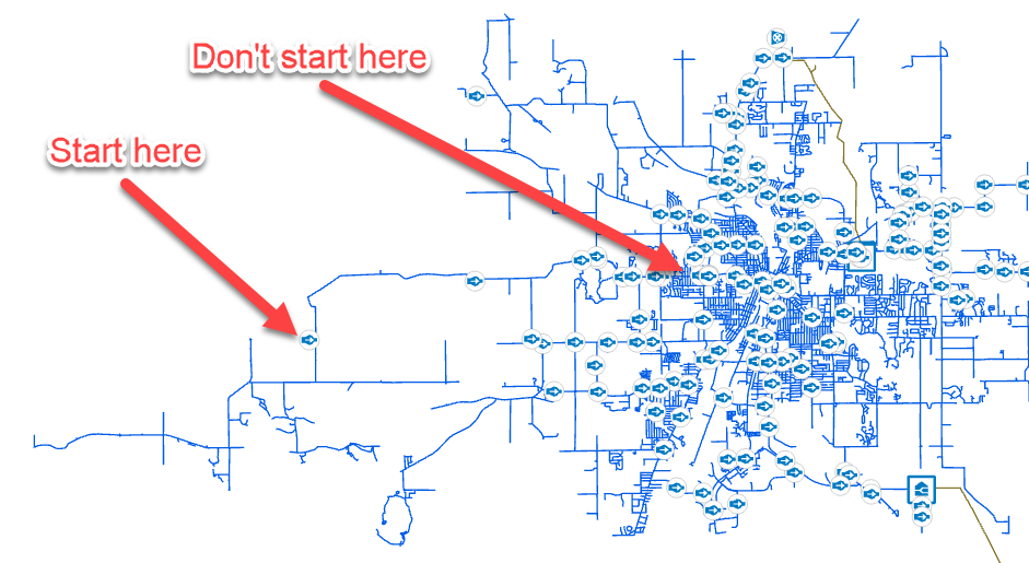

When starting this process, it can be difficult to know where to start, since you may have dozens or hundreds of pressure zones. This is further complicated when one pressure zone is nested inside another pressure zone. The temptation is often to begin as the highest-pressure pressure zones at the center of your system and work your way outwards, the problem with this approach is that as soon as you create your first pressure zone it will consume all downstream and nested pressure zones because those subnetwork controllers haven’t been configured to regulate pressure yet. Instead, it is often easier to begin creating controllers at the edges of your system and work your way inwards. In this way you don’t need to worry about nested zones, and if you make a mistake, you likely only need to investigate the connections with one or two neighboring pressure zones.
If you zoom into the regulator station on the western side of the service territory you can see that the inlet/outlet of this regulator isn’t immediately obvious. However, deciphering this can be made easier by turning on labels for the set pressures of each pipe.

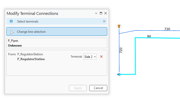

Similarly, it helps to look at the terminal each line is connected to. In fact, when creating subnetwork controllers, you should always verify that the terminal connections between your controller and device are correct. If they are not properly set this will cause problems when you trace your subnetworks. You can see the terminal connection using the Modify Terminal Connections pane on each connected line or, if you’re particularly clever, you can create a label class on the layer to show this information.
Because you assigned a BiDirectional terminal configuration, the terminals are specified as Side 1 and Side 2. If you had a directional terminal configuration you would want to see the 720 psi pipe on the upstream terminal and the 60 psi pipe on the downstream terminal. Now that you are confident in the terminal connections of our regulator, you can create the subnetwork(s). Use the Modify Subnetwork Controller pane on the regulator to create a subnetwork for the 60 psi pipe.
Ensure the tier is set to Pressure Zone and select the terminal connected to the 60 psi pipe. Because a subnetwork can have multiple controllers, you need to uniquely identify this subnetwork controller. If you have a unique name field you can use, put it here, otherwise you can leave this blank and the system will use the feature’s global id. Finally, put the name of the pressure zone in the subnetwork name field.
Once the terminal has been enabled as a subnetwork controller, you must validate the network topology for the feature before it can be used.

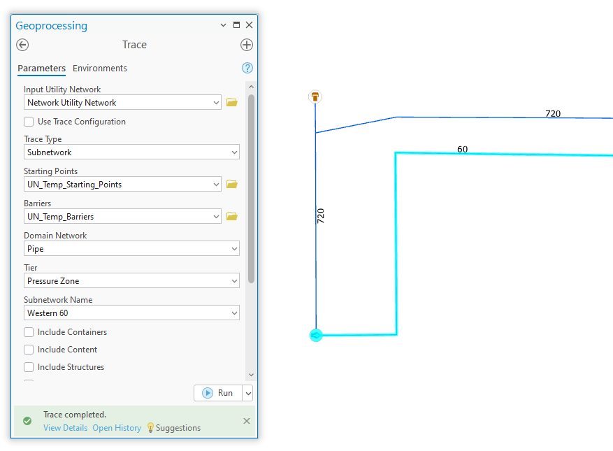

After validating the topology, you can then use the trace tool to trace the subnetwork and validate the correct result is returned.

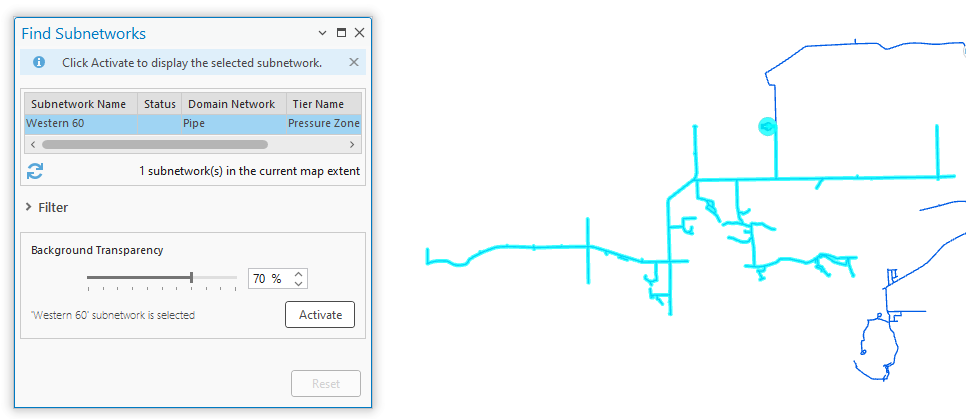

Once you’ve verified it traces correctly, use the Update Subnetwork tool to create the subnetwork for the first time.
Once the subnetwork has been successfully updated, you can use the Find Subnetworks pane to visualize the subnetwork. This pane can also be used to trace, update, and review the status of your subnetworks.
