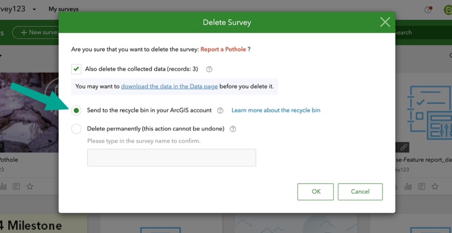

Recycle bin support on the Survey123 website
The new recycle bin feature enables deleted surveys to be retained for a predefined period, typically 14 days, before they are permanently removed. Initially introduced in Survey123 Connect with the June 2024 update, this functionality is now accessible on the Survey123 website as well..
Once the recycle bin is activated in your ArcGIS Organization, you will see the option to “Send to the recycle bin in your ArcGIS account” in the delete survey dialog. This allows for easy recovery of surveys in the event of accidental deletion.
Survey123 Web Recycle Bin

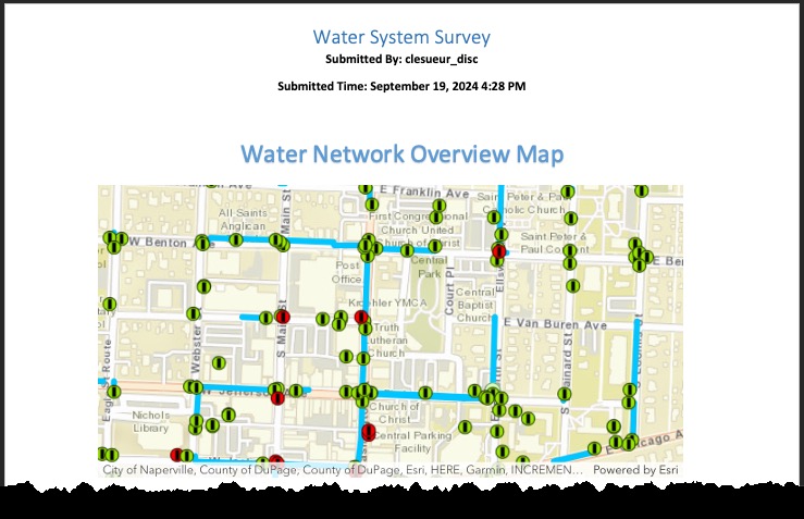

Printing web maps
This version of Survey123 offers enhanced flexibility and customization for incorporating maps into Survey123 reports. Previously, printing a web map in a Survey123 report required referencing a geopoint question in the syntax. For Example:
${geopoint1 | map:”dc0722c1c56c47268da4c1e046516b21″ | size:400:300}
This will display the collected point as a blue pin on the designated web map. However, there are situations where you may prefer to hide the blue pin, particularly if the web map already provides all the required information. In these instances, the new $map keyword in the report template syntax enables you to print the web map directly, eliminating the need to reference a survey question:
${$map | map:” 85b4c863faac44548cd96ca21a70e236″ | size:600:300}
Web map in report without Geopoint
New map filters for Survey123 reports
If you want to print only a subset of features from an operational layer in the web map, the new mapFilters:”<parametersForQueryOperation>” method is designed for this purpose. For example, if there’s a feature layer containing parcel inspections:
- ${$map | map:”7f2ef03be73a4b51b9e0480df46de7b1″ | mapFilters:”where=parcelID=’123-456-7890′”} –This prints only inspections for parcel 123-456-7890.
- ${$map | map:”7f2ef03be73a4b51b9e0480df46de7b1″ | mapFilters:”where=parcelID='”+parcelID+”‘”} – If you are printing an individual report for a parcel, this filters inspections to the current parcel. Here, the first “parcelID” is the field name, and the second “parcelID” represents the current parcel in the report.
