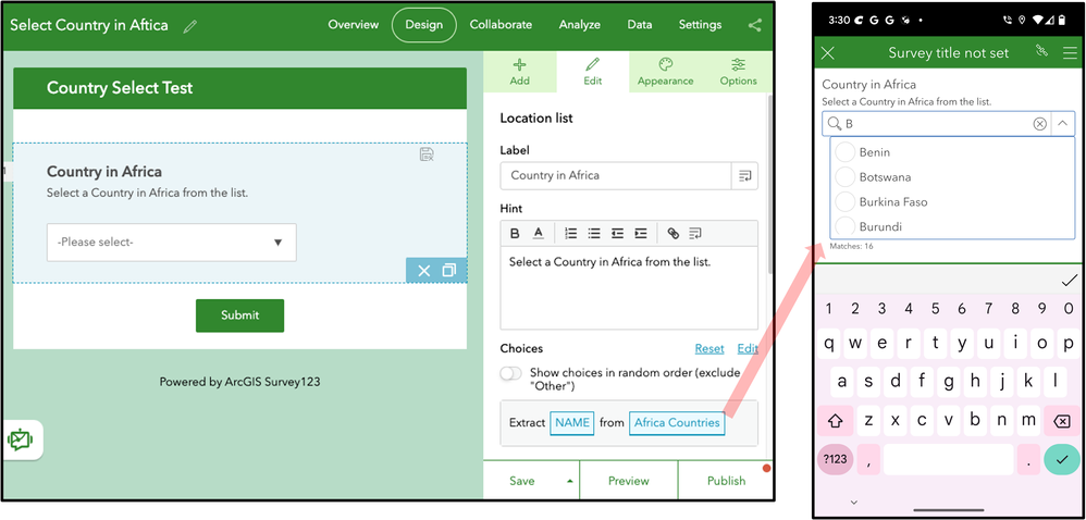

New Location list question in the web designer
A fundamental aspect of Survey123 is its capability to incorporate location data within your digital forms. The Survey123 web designer gives you the option of capturing location information through a GNSS/GPS sensor, by specifying a location on a map or by inputting an address. However, there are situations where the location options are predetermined, necessitating that the end user simply selects a location from a pre-established list. An example could be completing a form for a census track, country, or store location.  In this release the web designer now includes a new Location list question type.
The Location list question allows users to choose a location from a drop-down list. The choice is submitted as text and its corresponding geometry is submitted as the location for the survey response. The Location list question is populated from a feature layer and the layer can contain point, line, or polygon (area) features. This question type behaves in the same way as a select_one question with autocomplete and search. Learn more about the new Location list question in the web designer

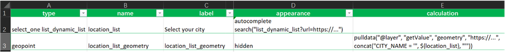

When authoring the Location list question in web designer, two questions are created in the behind xlsx form: a select_one question with the search appearance to populate the list, and a geopoint, geotrace or geoshape question with the pulldata(“@layer”) calculation to grab the geometry of a selected choice item:

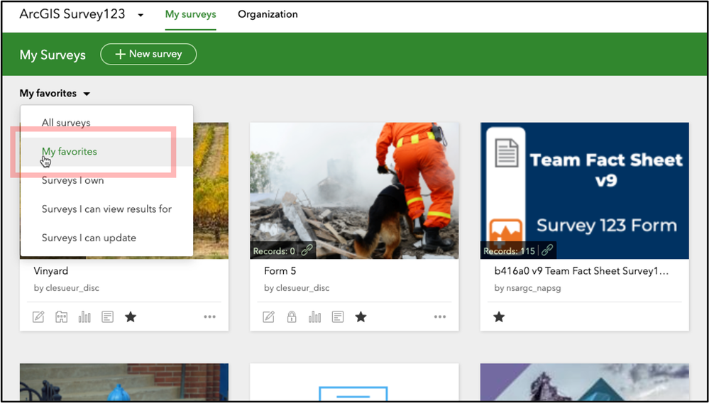

Organize your surveys with the My Favorites page
As our users continue to discover innovative applications for Survey123 within their organizations, they frequently encounter the need to manage a growing number of surveys. These surveys might be actively in use, under development, or perhaps older and archived. Our users have asked us for a more efficient method to organize and prioritize frequently used surveys, we are excited to introduce a new “Add to Favorites” button on survey cards, along with a “My Favorites” page in the My Surveys gallery. This enhancement is designed to streamline survey management and ensure quick access to your most valued surveys.

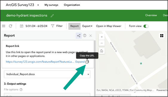

To get started, click the new share icon in the upper right corner of the Report panel on the Data tab. Copy the report link URL and open it in a new tab.
The new report page is similar to the report panel and offers equivalent capabilities. You can share the report page with others or embed it in other applications.
Additionally, URL parameters can be used to further customize the report page. For example:
  • `?inputFeatureTemplate=Hydrant {objectid}, Status: {status}` defines the feature template in the “Input feature” preview area.
  • `?hide=selectTemplate,showCredits` hides the “Select a template” dropdown and the “Show credits” button.
To learn more about this new report page, check out this help topic

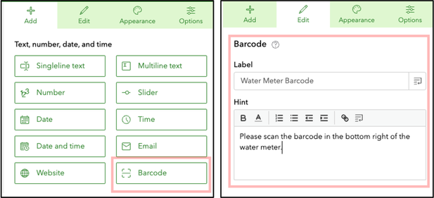

The Barcode question is now part of the web designer
You can use the Survey123 mobile app to scan barcodes using your device’s camera, no need for external barcode hardware. By simply scanning a barcode you can quickly capture the unique identifier and other asset information into your form. This helps to reduce errors and speeds up data capture. The Barcode question type is now available in the Survey123 web designer, which was previously only accessible through Survey123 Connect.

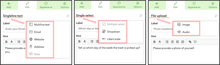

Change question type of an existing question for a published survey
Have you ever built and published a Survey123 form only to wish later that you would have used a different question type as an input?  Maybe you chose a Singleline text question but not regret not choosing an Email or Website question type.  Or you would prefer to change a Single select question to a Dropdown question. Good news! The Survey123 web designer now allows you to change the question type of an existing question in your form. It’s important to note that not all question types are interchangeable, and you can only switch between question types if the underlying field type remains the same. The image below shows some of the options available for changing question types. For more information see Update a survey.
