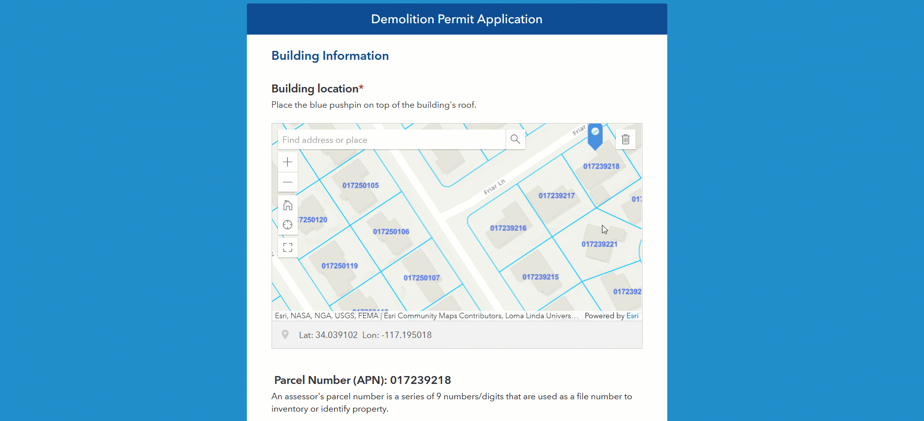

The animation below shows a typical scenario for pulldata("@layer"). A calculation takes the location set in the map, and triggers a point-in-polygon query to retrieve a value from the intersecting polygon; a parcel's APN (Assessor Parcel Number) in this case.
I can think of a gazillion cases where point-in-polygon queries will be handy... just think of the polygon layers you may have: parcels, soils, fire perimeters, sales territories, evacuation zones, city boundaries...

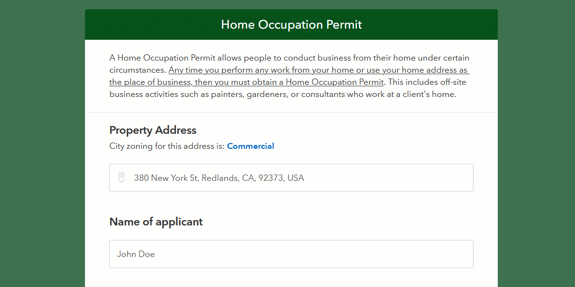

Point-in-polygon queries do not strictly require a map in your form: They require a location and a polygon layer. In the example below, the respondent enters an address, and a point-in-polygon query is triggered to automatically calculate the City Code that applies to that location. In this case, the location for your point-in-polygon query does not come from a map, but an address. The City Code comes from the feature layer targeted in your point-in-polygon query.
Point-in-polygon calculations will help you make your forms geographically smarter. You can choose to display the geo-calculated values in the form, or keep them hidden.

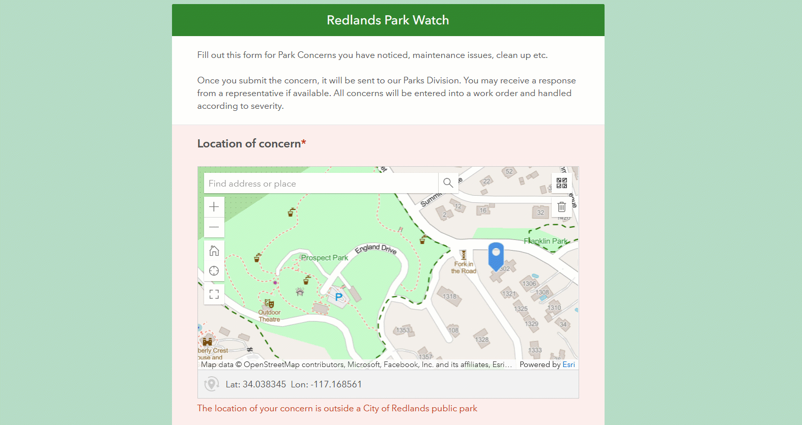

You can use the output of pulldata("@layer") to calculate a value, like in the examples above, or to feed a data validation rule. In the next animation, a point-in-polygon query checks if a reported incident falls within a City of Redlands public park. If it does, the report is accepted. If it does not, the user will not be able to submit the form.
Again, we are essentially doing a point-in-polygon query using pulldata("@layer"). In this case, the output of the query is used to check the integrity of the data.

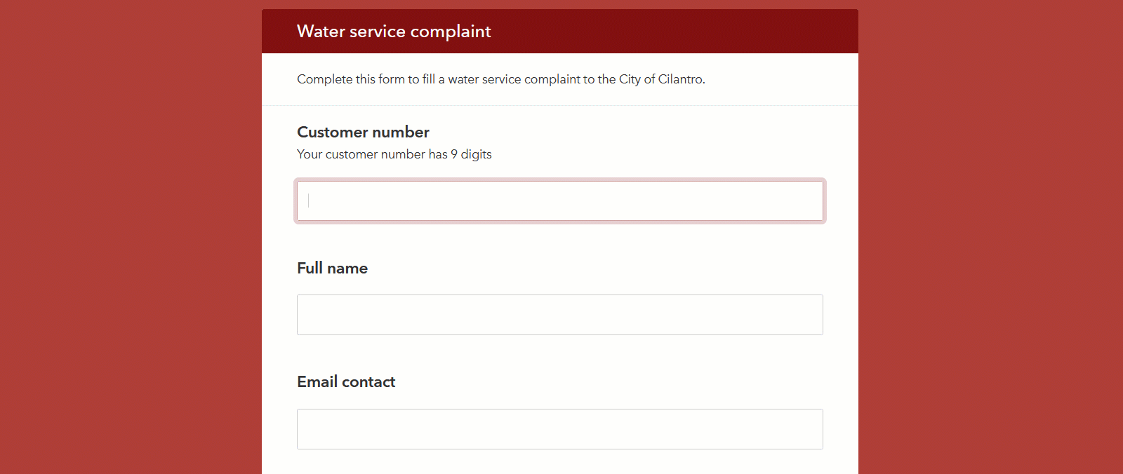

In the example below the respondent enters a customer number and the form automatically populates contact information about that customer. That is all done through pulldata("@layer"): The customer number is used to find a record in the customer layer. If found, the name and email attributes are populated.
Customers, assets, buildings, parts... You can query any ArcGIS layer or table as long as, of course, the user completing the form has access to the layer or table.

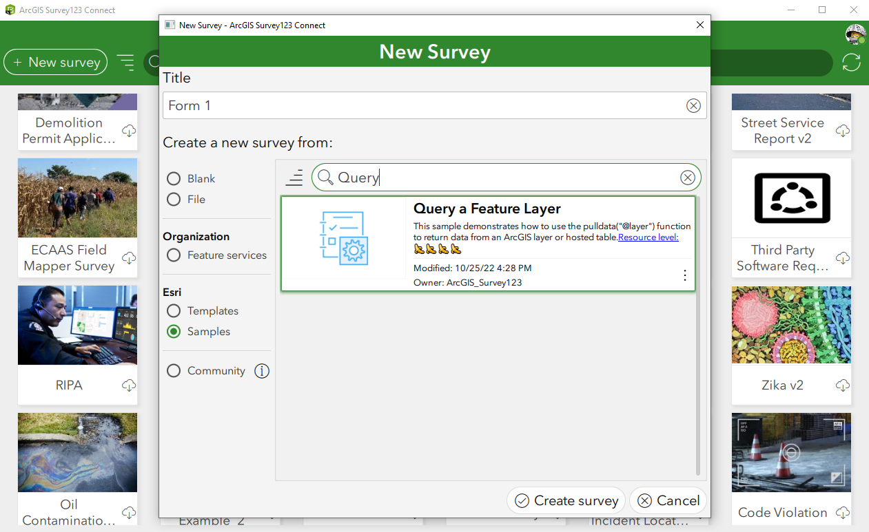

Survey123 Connect includes a sample called Query a Feature Layer. Have a look at it, as it illustrates some advanced techniques you can leverage to gather statistics and construct dynamic queries.
