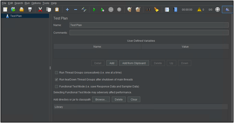

- Start Apache JMeter
- This automatically creates a new, empty Test Plan (e.g. a test project)

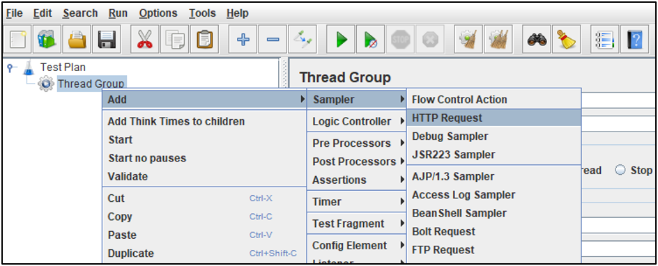

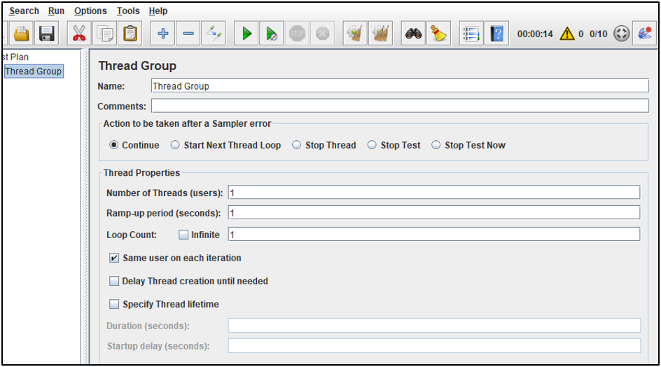

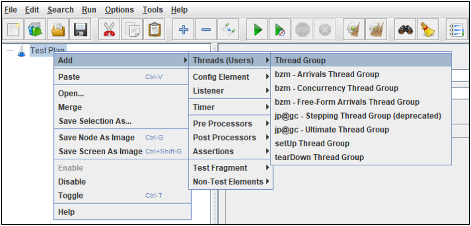

- Right-click on Test Plan and under Add-->Threads (Users), select Thread Group
- This is necessary for defining the test‘s pressure…if it will exert a step load or constant load
- “Thread Group” just includes basic logic for defining a test’s step load (e.g. the test pressure)
- Not every thread group will define a step...some are configured to just apply a constant pressure
- The default values of the Thread Group (Loop Count = 1) will have the test run and execute the added web URL resource only once

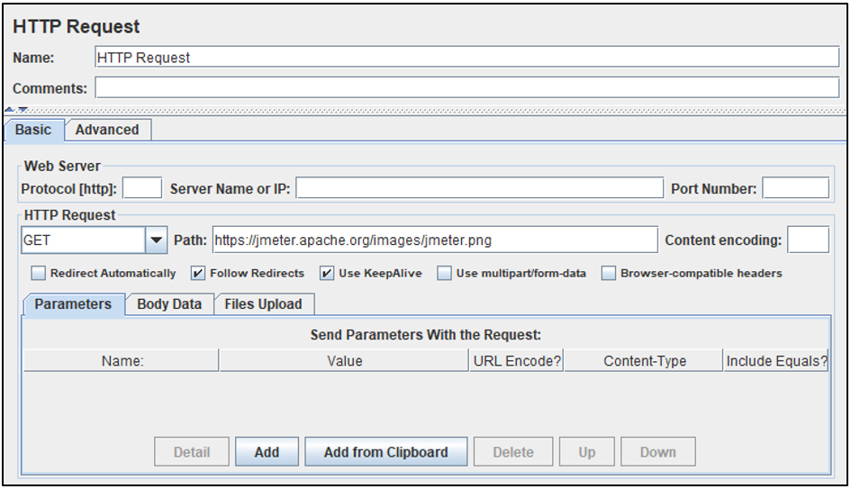

- Right-click on the Thread Group and under Add-->Sampler, select HTTP Request
- Copy and Paste a URL for a static resource into the Path field of the HTTP Request sampler.

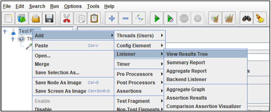

- Use the View Results Tree listener to assist with validating the response in the GUI from the remote server
- Right click on the Test Plan and under Add-->Listener, select View Results Tree

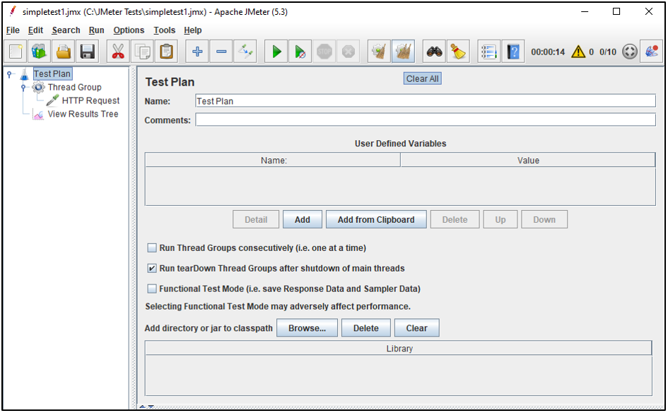

- Click back on the Test Plan and save your project
- File-->Save
- You will be prompted for a location to save your JMX file (your Test Plan)
- E.g., simpletest1.jmx

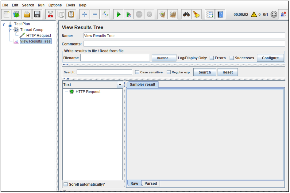

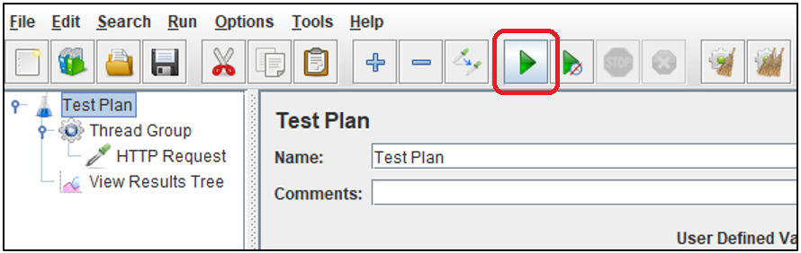

- Visually validating a Test Plan can be easy thanks to the View Results Tree listener.
- Simply click on the green triangle at the top of the Apache JMeter GUI, then select View Results Tree
- This will just send only one request for the image we specified, then stop the test
- This is by design with the default configuration of the “Thread Group”
- A green shield with the words “HTTP Request” should be observed in the Text section
- The “green” denotes a successful request and response
Note: Sending only one request helps prevent the "load testing" of the jmeter.apache.org site, which should be avoided.

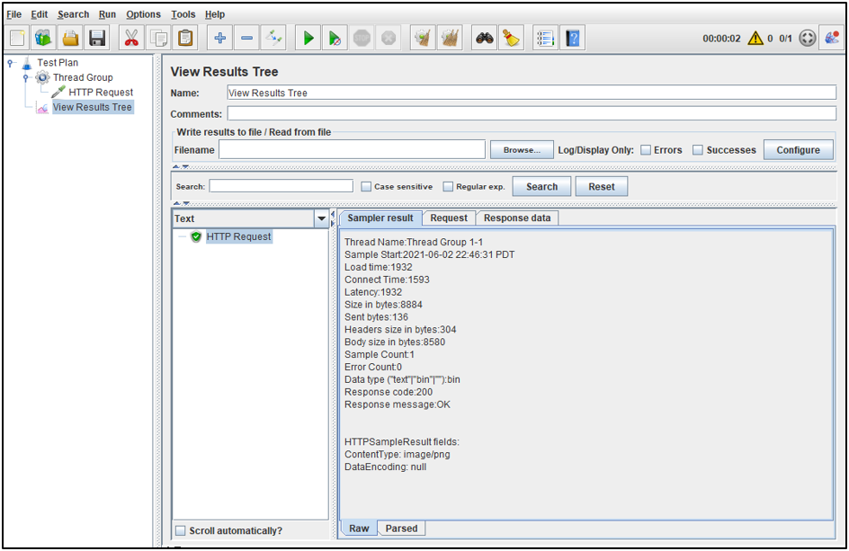

- Clicking on the green shield or HTTP Request, followed by Sampler result will show some key information by the remote server
- Load time (response time)
- Size in bytes (Header and Body)
- Error Count
- Response code
- ContentType

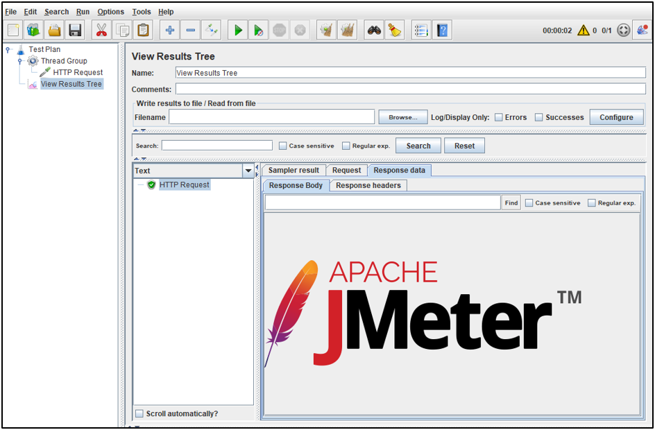

- Clicking on the green shield or HTTP Request, followed by Response data then Response Body will show the payload returned by the remote server
