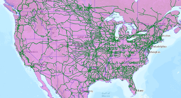

Let's suppose you add this Map Service to your content in ArcGIS Online/Portal for ArcGIS: https://sampleserver6.arcgisonline.com/arcgis/rest/services/USA/MapServer

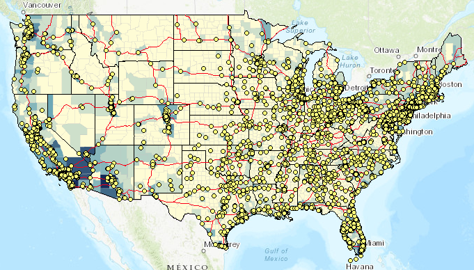

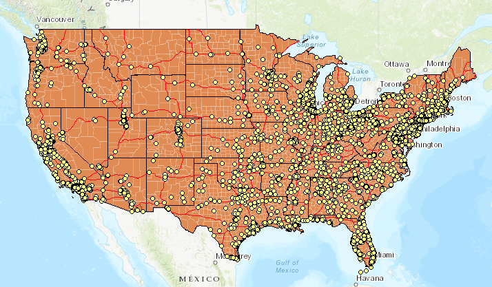

You add the item to a Web Map and for a little while it suits your needs:
But one day you decide that you don't really like the color orange and would get more use out of the Web Map if you could better visualize total population of each county.
After some time, you settle on the symbology included in the attached webmaplyr.json. It's a bit a long so I won't include it here - this is fine because you probably won't want to define the JSON in your script anyway, preferring to read from a file.

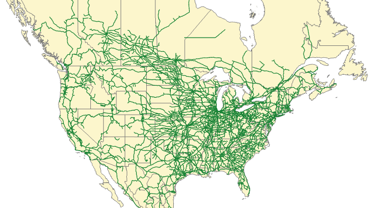

The original Feature Service looks like this:
The JSON for this example isn't very long. I just make a few changes to color and width on the States/Provinces layer:

The update result:
That concludes this overview on how to update layer symbology. Hopefully with this guide you can get a good sense of how to implement similar workflows in your organization!
