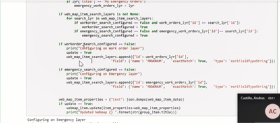

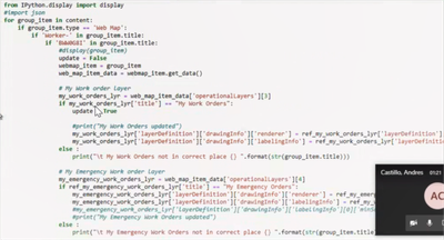

That's great, thanks for the write-up. But it would be really nicer and helpful if your snippets were posted as code blocks instead of images, don't you think?

I've been using the above approach updating the layer source, i.e to point a layer Url into another one
The methodology to update a web map can be summarized as such:
Get the web map json (item.get_data())
Similar to the ArcGIS Rest API:https://developers.arcgis.com/rest/users-groups-and-items/item-data.htm
2Prepare the web map dictionary by overwriting the chosen dictionary values with the desired values:
3Update the target web map (item.update(item_properties=desired web map dictionary keys:values))
https://developers.arcgis.com/rest/users-groups-and-items/update-item.htm
