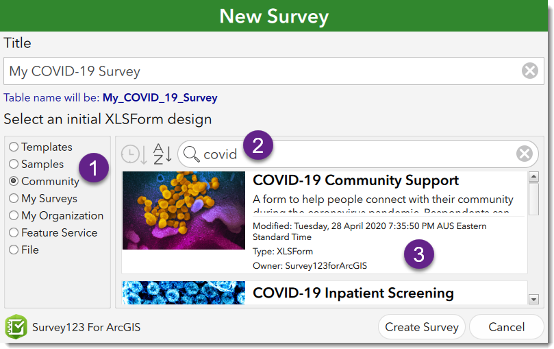

If any of these templates is of interest, you can use them as a starting point for your own project. To download the templates, head to the Community samples section in Connect. In Survey123 Connect, select New Survey. Select the Community option (1), enter a search for "COVID-19" or "coronavirus" (2) and then select a sample survey from the list (3).
