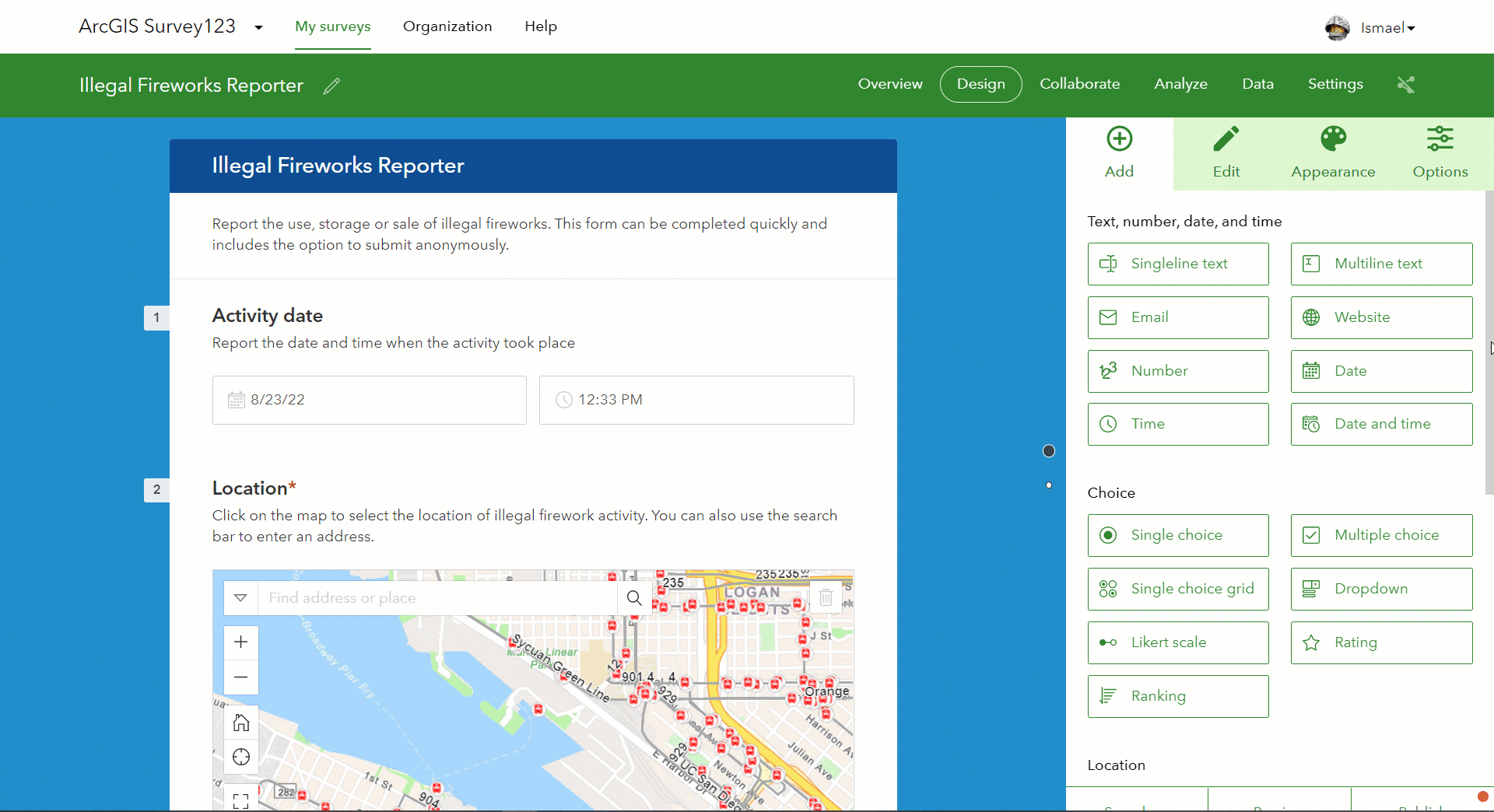

Web designer: Question types reorganized in the Add panel
You will find that the Add panel in the web designer now looks different. We added new question types recently and it was getting a little busy. We also have more in the works so this is the right time to reorganize.
Note how question types have been split into different groups. This makes it easier to find the question type you are looking for.
Note: The switchers to show and hide the survey header, description and footer are now in the the Add panel. Scroll to the bottom!

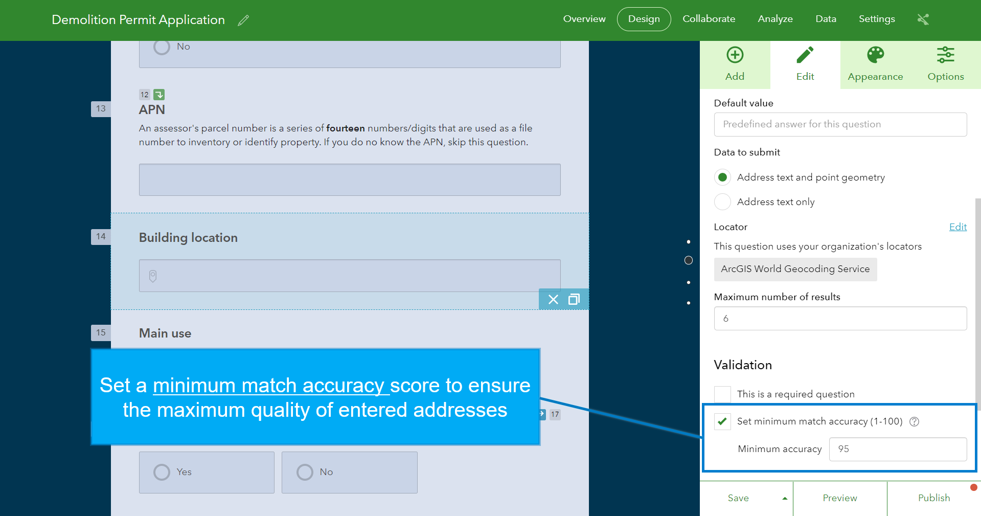

Web designer: Enhanced data validation options for addresses
You might be familiar with the address question type. If not, check this post for details. This release introduces the concept of minimum address accuracy, which you can optionally set to boost the quality of your address data.
As respondents type an address, Survey123 checks how well the text entered matches existing entries in your locator. A perfect match gives a score of 100. It is always good practice to store the match score as an attribute. That way, you will know how good your location data is! Additionally, you can now use the accuracy score as a data validation rule: If the score is below your threshold, the address will not be accepted.
Note: You will want to use this new feature with caution. For example if your locator is not up to date, it is not a good idea to pick a high score.

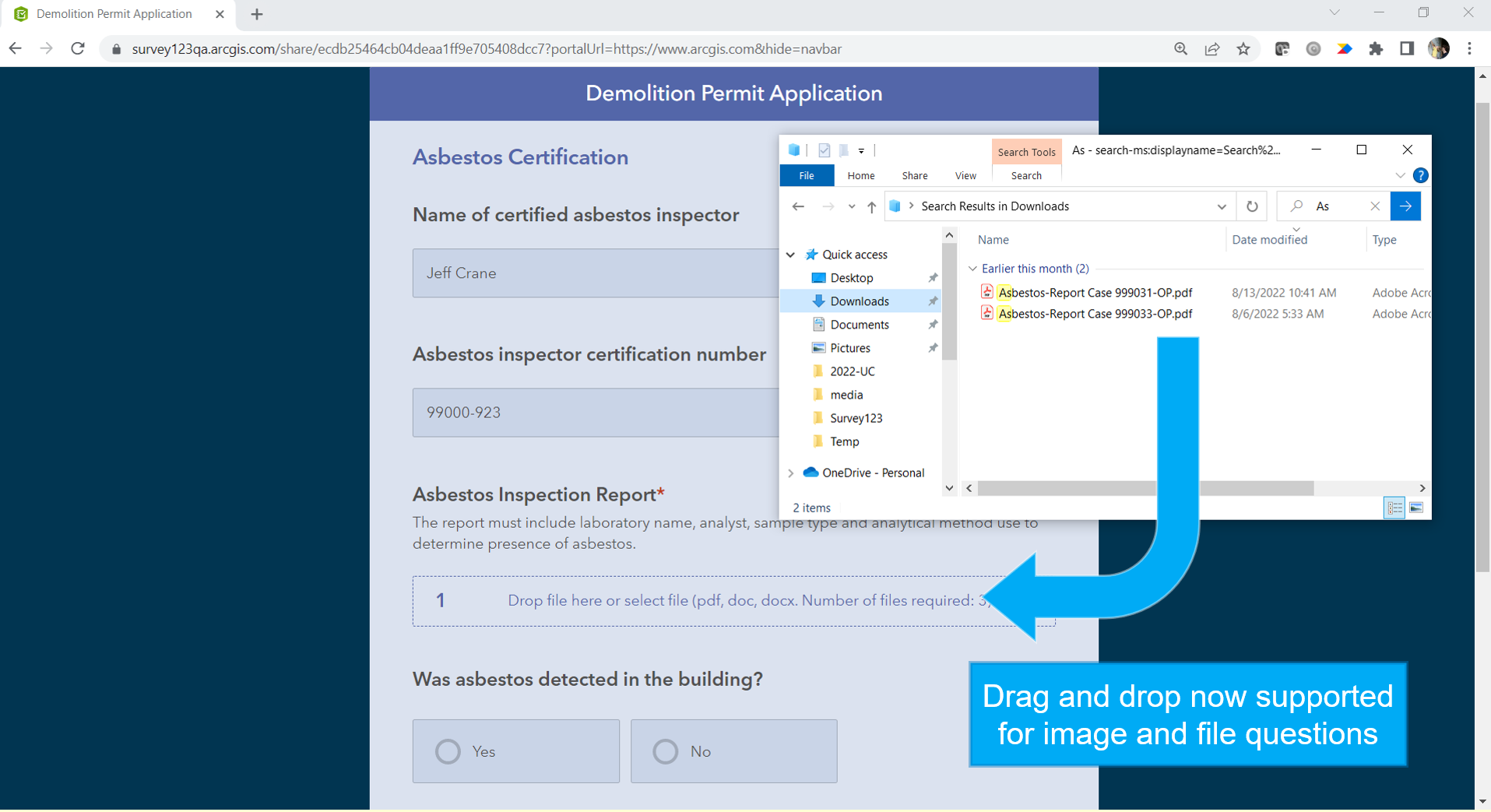

Survey123 web app: Drag and drop images and files
Do you want to upload a PDF or some other file as part of your form? Simply drag and drop your files and Survey123 will do the rest. This new feature is particularly useful if you complete a form on a laptop or desktop computer.
