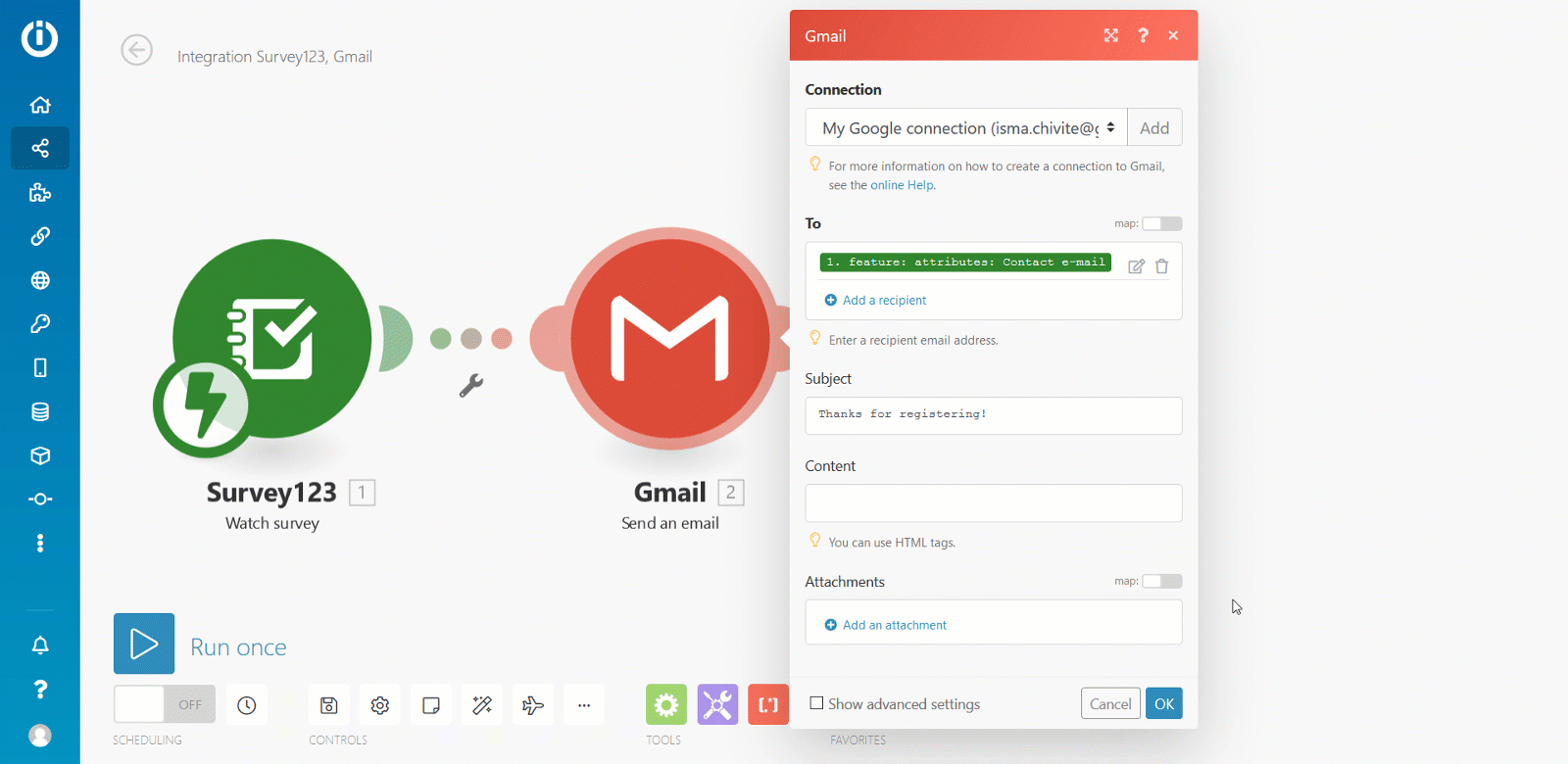

Including an edit web form link in an e-mail.
In this scenario, we will use a web hook to automatically send an e-mail to the user submitting the survey. This email will contain a link for the user to complete or make modifications at any time. To do this you must be familiar with web hooks in general or with either Microsoft Flow or Integromat. Like in the examples above, the trick is to be able to dynamically populate the globalId of the record you want to edit. Luckily enough, the payload of a Survey123 web hook includes information about the user submitting the data (if logged-in) as well as responses to questions in the survey. So as long as the user is logged-in or a specific question in the survey captures the contact e-mail, you can make this work.
Here are the high level steps:
- Create a new survey. If you plan to share your survey publicly, include an e-mail question and make it required. If you plan to keep your survey secured, you will be able to get the e-mail from the logged in user's profile.
- Use Microsoft Flow or Integromat to automate e-mail notifications when your survey is submitted. The globalId of the record submitted is included in the payload of the web hook. Simply add the globalId to the URL of your edit web form when you add the link in the body of your e-mail.
Here is some visual aid in case you are using Integromat.
If you are using Integromat or Zapier, the pattern is pretty much the same: use the webhook payload to retrieve the globalId of the submitted record and use if for your edit web form url.
