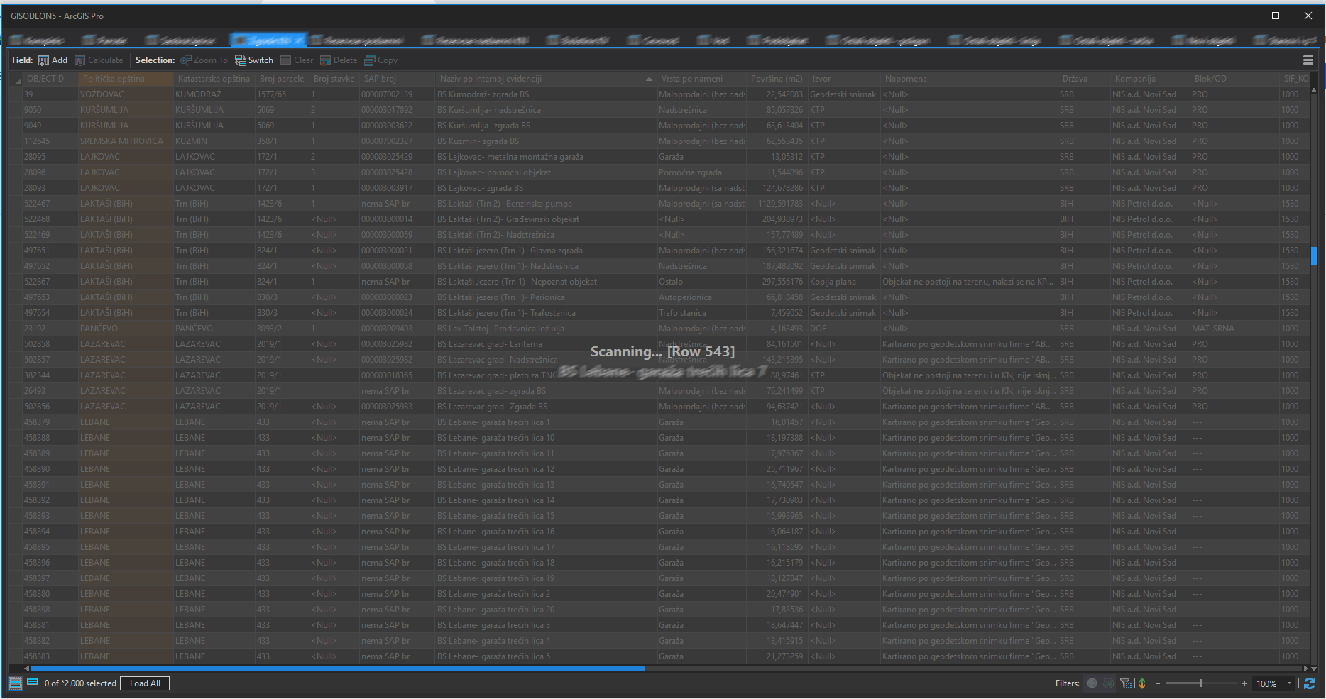

to navigate through table . Especially when I want to jump to the end of table (or begin for that matter). Yes, I could use combination Ctrl- Arrow, but it is not always convenient. - Load all
is very, very annoying, to say the least. It appears as developers opinion, a table with 2000 or more entries is too much for modern computers memory to handle. Come on! Two thousand rows? And they put in that annoying Load All button and no matter if you click it and table loads all rows, after first operation in table it jumps back again to Load All state and shows only the first two thousand rows. I would like it, when I say Load All, then it loads all and stick with it. Don’t jump back to Load All! Why wouldn’t we have a possibility to change it ourselves? I would say, it should be in settings, where you could set the number at how many rows in table it goes in mode Load All. Furthermore, here should be a check box “Do not switch to Load All ever” and so my ArcGIS Pro would ALWAYS load ALL rows in the table. It would be my responsibility to assess if my system is enough performant or not. Or for example, I could set it to switch to Load All mode only when there are more than 50000 rows in the table, how about that? - Scrolling through the table is very laborious. You do not get to see rows scrolling in front of your eyes (except appearently when there are less then 2000 rows). Instead, you rather see just a useless counter of rows and when you stop scrolling (and don’t let loose the mouse button) you can see value of some field in the table.
For me, this is useless as it gets, I do not need no row counter and I do not need some irrelevant field value. I understand, this value is the first field most above in the screen of some attribute. But, what I need is to see all rows and not this funny game with disappearing of rows and displaying row counter. Except that, I have no slightest idea, how is determined of which attribute is showed the value and if I can change it or not. It seems, for different tables it is different attribute.
