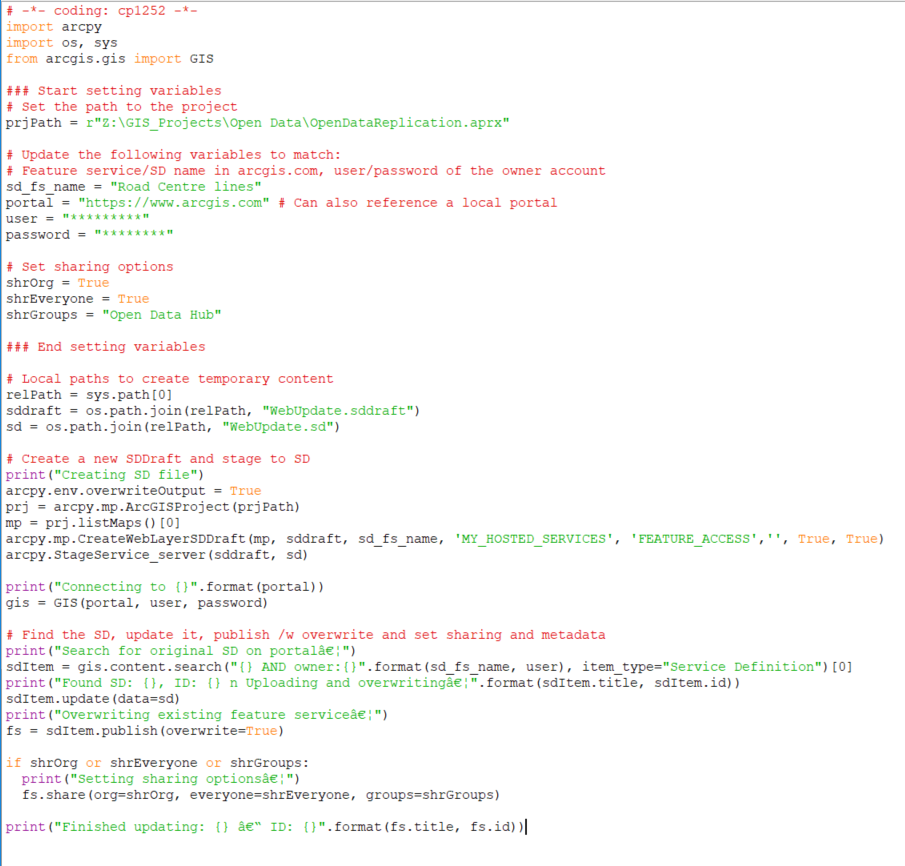

Tweed Shire Admin‌ can you post the code you are executing?
GlenShepherd
Hi Jake, I'm currently working with Tweed Shire Admin to try and resolve this issue.
Code is as follows:
- User is unable to run a python script that overwrites a feature layer in ArcGIS Online
- Script is fine, and I can run her script (even with her credentials included) from my ArcGIS Pro
- Issue is not specific to her machine
- Complete uninstall and reinstall did not resolve the issue.
- Error message cites Runtime error
- Script tested same problems in Python window of ArcGIS Pro and IDLE
- Replicated on another machine within the network
- Replicated on a laptop outside of the network
- Comprehensive uninstall and reinstallation had no effect
- Client cannot manually overwrite the feature service from Pro either
- Systems check revealed machine environment is fine for Pro
- There are no other feature services published from the same data
Same error received as bbaker_mhgis
JakeSkinner
Esri Esteemed Contributor
Hi Glen
If ArcGIS Pro is not working correctly, the code will most likely not work.  I would focus on getting Pro working, then circle back to the code.
