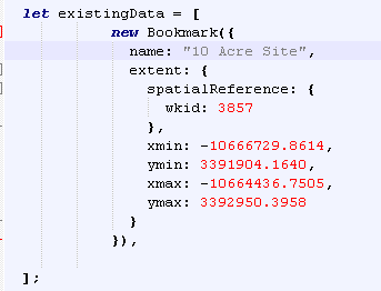

DianeBird
Yes - I was able to add it to the code as follows:
It works perfectly, and I can still add new bookmarks to the list.
