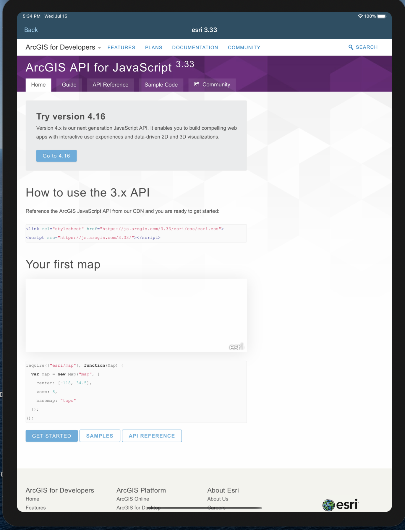

HectorMeneses
I modified my app to point to the following site in esri:
https://developers.arcgis.com/javascript/3/
the app using WKWebView fails to display the sample map.
However, if I use safari in the iPad simulator the same page displays the sample map without trouble.
Here it is with WKWebView:
esri sample map does not display in WKWebview
The same page displays just fine in the iPad simulator safari browser:
esri sample map displays in safari
Anybody else has this issue?

HectorMeneses
Hi Kasper,
The error we were facing was related to the handling of self signed certificates in the didReceiveAuthenticationChallenge method. Basically, we were cancelling all requests if they didn't match one of our host domains. Instead we needed to call PerformDefaultHandling in the completionHandler.
I think your issue is different... it sounds like the server side needs to change to allow Cache-Control in your Access-Control-Allow-Headers setting.
