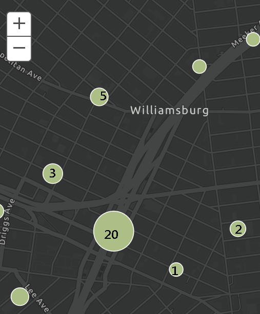

Hi everyone!
Does anyone know how to add  the label of the count of the clustered points using the class FeatureLayer 's featureReduction atrrtibute?
The result may like the following picture which each circle showing a label with the count of clusterd points.
The class FeatureLayer clustering sample link is  ArcGIS API for JavaScript Sandbox .
